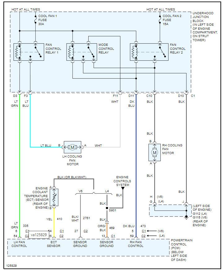

Did you find the problem? My 2000 Olds Alero 2.4l is doing the same thing with the cooling fans not coming on unless I turn the A/C on and then off.
Sep 7, 2021 at 11:34 AM
It is doubtful that this person will respond as it is well over 10 years old.
So let's try and solve this so that others will benefit from your solution.
If the fans only come on by turning the A/C on and off, then I suspect we have a temp sensor issue or a PCM issue that is not turning them on.
Let's start with checking for codes and then we need to check the relays.
Basically we need to monitor the left hand cooling fan control. Clearly we know the relays are working when the A/C gets turned on but if the PCM is not turning them on when it should then that is either a sensor or PCM issue.
So let's check the wire to find out if the PCM is grounding the relay 1. Put your test light on battery positive and the probe on the light green wire. If the light of the test light comes on then the PCM is grounding it and the fan should be on.
If not then it is a relay issue.
Please see the wiring diagram below and let's go from there. Thanks
Sep 7, 2021 at 7:59 PM
CORY ROBISON
Thanks for the reply. I’ll check the wires you mentioned and let you know what I find. Additionally, I replaced the ECT sensor and still have the same issue. I have a OBD2 code reader that also has data stream built into it. I had no trouble codes relating to the coolant temp sensor before replacing it. The new sensor also has no troubles codes. I have seen the coolant temperature on my code reader reach 222 degrees and the fans still never came on (with the A/C off the whole time) I had to turn the A/C on and then back off to get the fans to engage to cool the engine back down.
Sep 11, 2021 at 3:14 AM
Okay. You said you had no codes related to the ECT. Did you have any codes at all?
However, I suspect we have a PCM issue. If the fact that you turn the AC on and the fans kick on then you are basically tricking the PCM because it is supposed to turn just the cooling fan on when the engine gets hot. Then when the A/C is on, the condenser fan needs to be on as well. So the issue is, the PCM is not seeing the ECT signal as a trigger to turn the cooling fan on but then when you turn the A/C on it naturally turns both fans on.
This sounds like a controller issue. A relay issue is unlikely because it is able to turn the fan on as soon as you turn the A/C on so we know that if it just gets the signal to turn on, it is able to do it.
This means we need to jump to testing the control wires from the PCM. Remember these are ground control so you need to put your meter on 12 volts and then the other lead on this wire to find out if it is applying the ground. I suspect it is not until you turn the A/C on and off.
Also, it is unlikely that the ECT sensor is the issue if you can read the coolant temp from the PCM. This means the PCM is getting the signal but it is just not grounding the relay like it should.
Hopefully this makes sense. Let me know if it doesn't. Thanks
Sep 11, 2021 at 8:43 AM
CORY ROBISON
I did the test you suggested where I connect my test light to battery voltage and the probe to the relay ground for the coil side. What I found was this: with the A/C off and the engine running hot (slightly above half way on the temperature gauge) there was no ground on the light-green wire. When I turned the A/C on, the fans engaged. Turned the A/C back off and the fans stayed on. Removed number 1 control relay, both fans shut off, and I test the same ground wire, there was ground and the test light came on. So I think it’s safe to conclude that I have an internal issue inside the PCM. Unless there is a ground wire coming from the PCM to chassis ground that’s bad. But if this were the case, I would think it would affect more than just the the cooling fan control. What do you think?
Sep 17, 2021 at 8:12 PM
I am not looking at the vehicle to know for sure but based on this info, I agree 100% with what you are thinking. If the fans do come on then we know for sure they are working so they are just not being commanded on which would be the PCM.
If it were me, I would replace it and go from there. Let me know what happens. Thanks
Sep 17, 2021 at 8:38 PM
