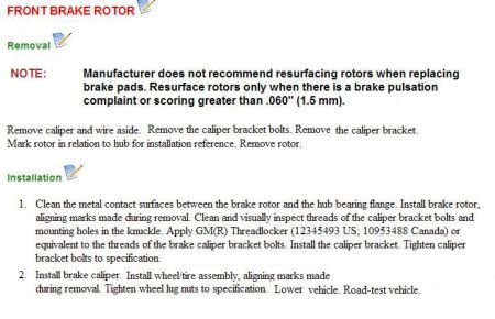

how do you change the front brake rotor on the 2000 Olds Alero

https://images.2carpros.com/forum/automotive_pictures/261618_Noname_1016.jpg
