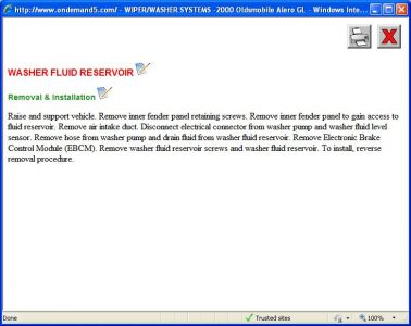

2000 Oldsmobile Alero 4 cyl Two Wheel Drive
I HAVE A 2000 OLDSMOBILE ALERO. I NEED TO REPLACE THE WASHER FLUID RESERVER. LOOKING AT IT, IT LOOKS A LITTLE CONFUSSING. DO I REMOVE THE BATTERY THEN REMOVE THE RESERVER? OR DO I REMOVE THE RESERVER FROM UNDERNEATH THE CAR? I JUST NEED A LITTLE ADVISE ON HOW TO GET STARTED AND I THINK I WILL BE OKAY AFTER THAT. I HOPE...

https://images.2carpros.com/forum/automotive_pictures/416332_2000_oldsmobile_alero_replacing_washer_bottle_1.jpg
Here you go.
