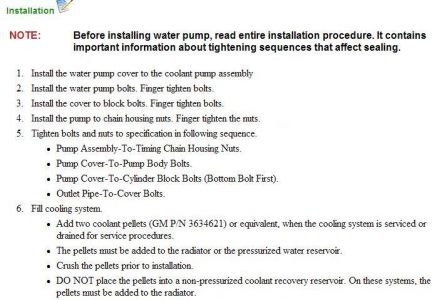

I need to know how to change the water pump on my Olds Alero I was told that I would have to get into the inner working of the engine to accomplish this task.
