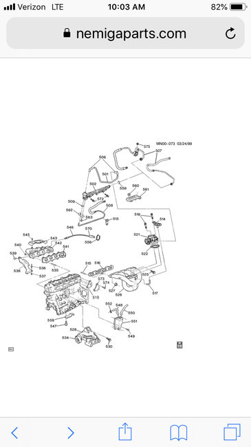

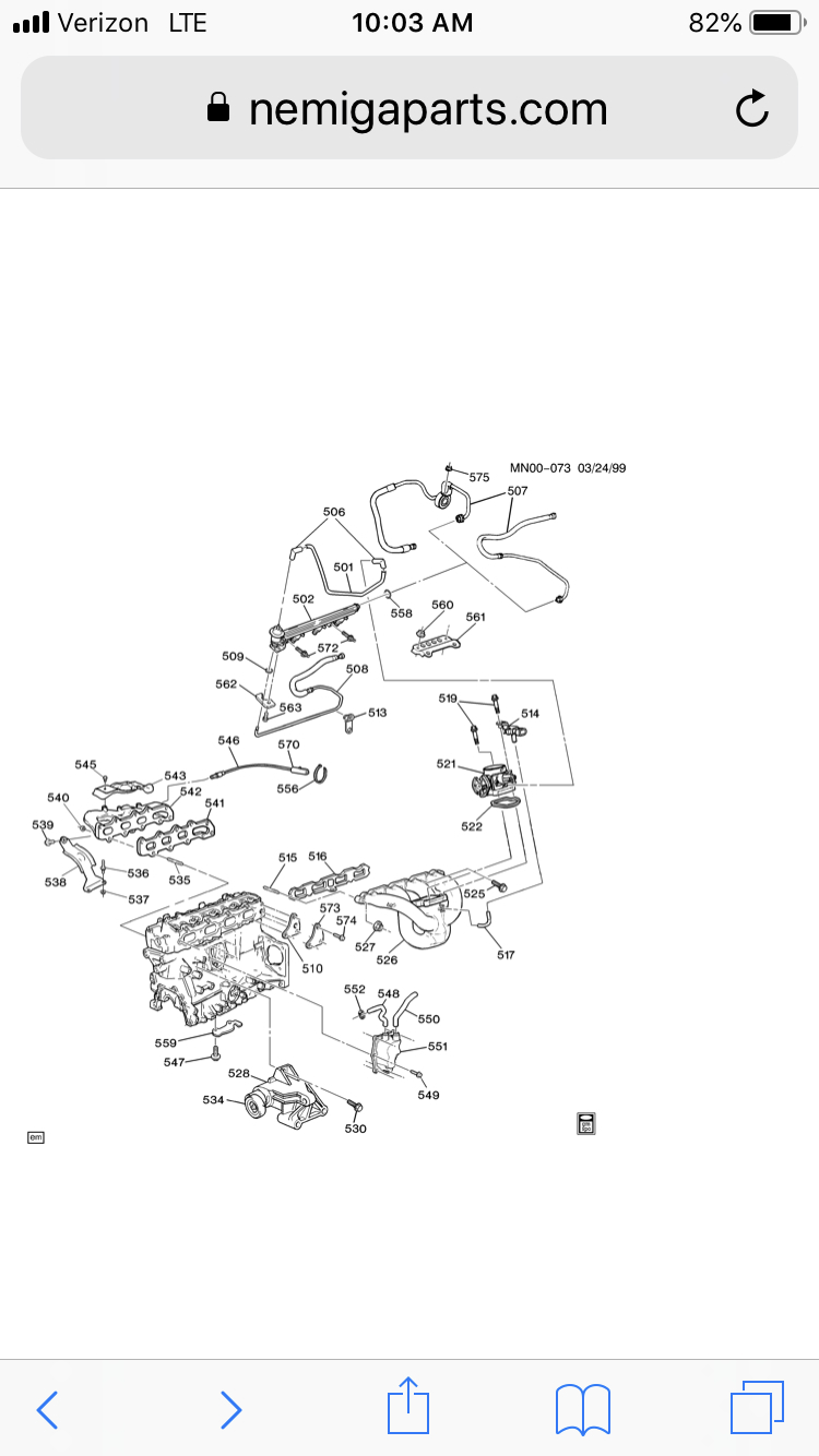

I just replaced my MAP sensor hose vacuum line and it was the culprit. It’s about a 4 inch fitted rubber hose in the front of the engine right about in the center. Here is a picture of the part (#517)
