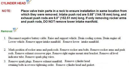

I would like to replace the headgasket from my car but I do not have much expirience any help I can get from you guys will be great. Thank's
Thursday, December 3rd, 2009 AT 3:01 AM
BLUELIGHTNIN6
  • 16,542 POSTS
https://www.2carpros.com/forum/automotive_pictures/261618_Noname_1275.jpg
https://www.2carpros.com/forum/automotive_pictures/261618_Noname2_380.jpg
