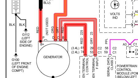

A new battery and alternator were just installed 3 days ago because they both burnt out at the same time. Now today my charging system light came and I have no idea why? What could be the problem now?

Inspect the alternator belt tension-all connections on the battery and alternator-if okay could be a problem with the alternator field control from the computer
https://images.2carpros.com/forum/automotive_pictures/12900_alty_21.jpg

what if it is the alternator field control from the computer?
Jul 11, 2008 at 1:25 AM
  • 75,992 POSTS
You need to triple check the charging system wiring connections-The PCM is not cheap-wrong move you'll end up having an extra one that you don't need-
