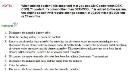

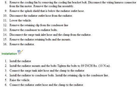

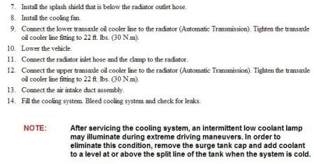

Instructions and pictures of how to replace radiator on the 1998 Achieva if different from other cars. My husband is having trouble removing the old radiator. Any suggesiitions?

https://images.2carpros.com/forum/automotive_pictures/261618_Noname_1250.jpg
https://images.2carpros.com/forum/automotive_pictures/261618_Noname2_368.jpg
https://images.2carpros.com/forum/automotive_pictures/261618_Noname3_141.jpg
