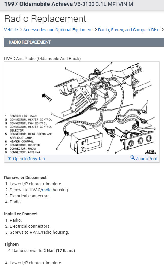

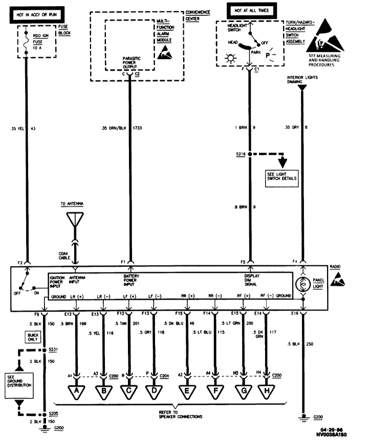

Radio static can be due to weak antenna, bad ground or faulty head unit.
If the static level changes as you drive around then it is likely an issue with the antenna.
As it is not able to provide sufficient signal.
If the static level stays the same regardless of your location then the issue could be a bad ground connection. Check the ground connection for the radio head unit. This will require to remove the head unit and trace the wire to the ground.
If the connection is loose or corroded, it will need to be cleaned and secured.
You can also unplug the antenna wire from the head unit to see if you can still hear the static. If it goes away, then there is an issue with the antenna wiring.
I have attached the wiring schematics for your reference.
