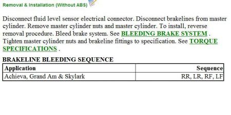

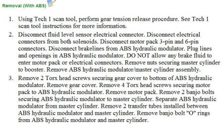

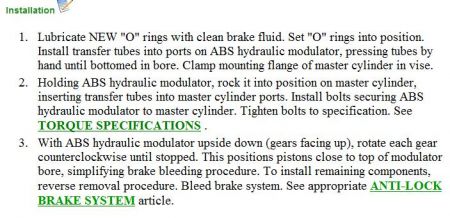

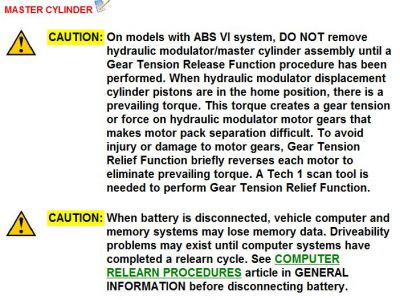

I need to know how to remove and replace master brake cylinder and proportioning valve that comes as one unit.
Sunday, March 15th, 2009 AT 6:07 PM
ZACKMAN
MECHANIC
4,202 POSTS
SPONSORED LINKS
Sunday, March 15th, 2009 AT 10:53 PM
