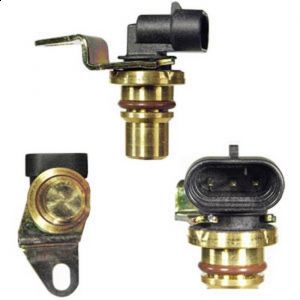

I need to replace the camshaft sensor and crankshaft sensor in my vehicle. Unfortunately I am unable to locate either ones exact location so that I am able to do so. If someone could tell me where they are located on the "block" and tell me how to replace them I would greatly appreciate it. A Diagram of the engine would help a lot also because i am unable to find one on the internet.

camshaft sensor Under hood, center, upper engine area, mounted on front of intake manifold Look exactly like this one:
https://images.2carpros.com/forum/automotive_pictures/46384_8_6.jpg
crankshaft sensor Under hood,front engine area, mounted on the center portion of the cylinder head look like this one:
https://images.2carpros.com/forum/automotive_pictures/46384_9_1.jpg
You need to remove the connectors and unbolt them from the engine block
