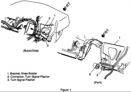

My car is a work of art, it's been running great. except my turn signal flasher has gone out, and i cannot find where to put the new part. I don't want to take it in, and pay for someone else to do it when i can do it myself. I just have the problem of locating it, some say by the fuse box, behind the radio, but it's not there, unless i overlooked it. Please help! Thank You

its #3 in the diagrams. Please let us know if you need anything else to get the problem fixed.
https://images.2carpros.com/forum/automotive_pictures/12900_flasher_43.jpg

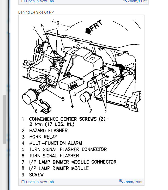

I need instructions on how to remove and install a flasher on a 94 Oldamobile Achieva

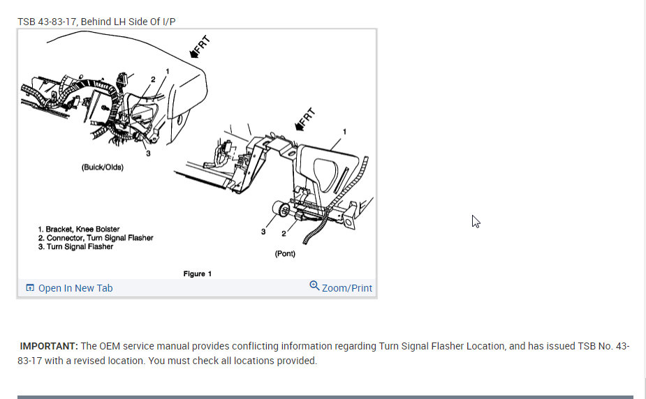

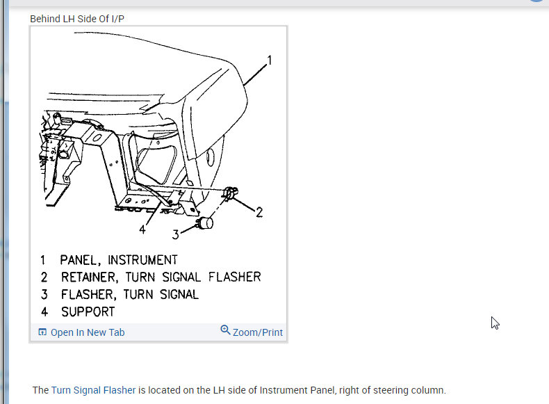

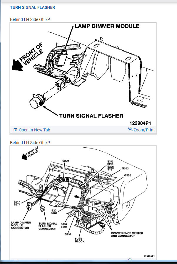

Your hazard flasher relay is in the convenience center behind the left side of the dash and the signal flasher relay is behind the left side of the dash, right of the steering column. Just pull them straight out, like a fuse, to replace them.
Dec 7, 2020 at 4:39 AM (Merged)
I am attaching the location information for the requested vehicle. Please let us know if you have other questions. Thanks
