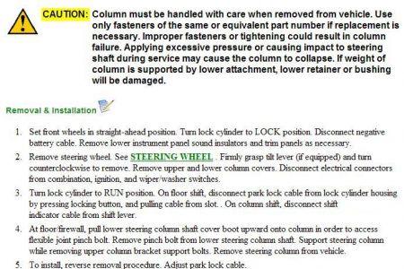

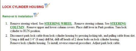

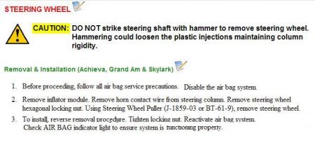

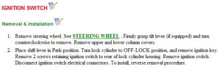

i need to remove the ignition to have rekeyed. Its okds achieva s. how do i remove nd do i need special tools. no air bag thank you

https://images.2carpros.com/forum/automotive_pictures/261618_Noname_1595.jpg
https://images.2carpros.com/forum/automotive_pictures/261618_Noname2_487.jpg
https://images.2carpros.com/forum/automotive_pictures/261618_Noname3_183.jpg
STEERING COLUMN
https://images.2carpros.com/forum/automotive_pictures/261618_Noname4_91.jpg
