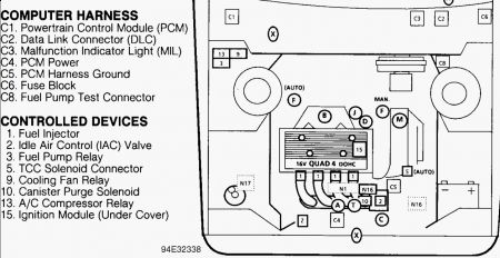

Can you please tell me where to find the canister purge solenoid that you refer to? The flowchart looks like it will help once I have located the solenoid. Also, the flowchart refers to using a "Tech 1 Tester" which I am not familiar with. I do have an OBD I and and OBD II scanner. Thanks for your help.

You will most likley either need to have OLds dealer check it, or take a shot and replace it, the tester is a GM shop tool. Or test it with an ohm meter and a hand held vacuum pump: Canister Purge Solenoid (Normally Closed) 1. Disconnect canister purge solenoid harness connector and vacuum hose. Apply 10 in. Hg to ported intake manifold vacuum side of solenoid valve. If vacuum holds, go to next step. If vacuum does not hold, replace canister purge solenoid. 2. Using a 12-volt power source, energize canister purge solenoid. Vacuum should release. If vacuum does not release, replace canister purge solenoid. Solenoid resistance should be at least 20 ohms. Page 1 of 1 3/1/2010 ...
It's located on the top right front of the engine, # 10 in the diagram.
https://www.2carpros.com/forum/automotive_pictures/62217_cannister_purge_sol_1.jpg
