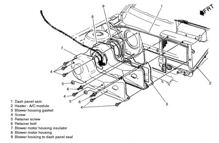

What is this tube attached to the blower motor called, what does it do and how do I attach it. I took this off and the smaller plastic tube inside it that was connected to the blower broke, so now I cant connect these two pieces. [img:13e9726e02]http://www.2carpros.com/forum/automotive_pictures/522322_Olds_3.jpg[/img:13e9726e02]

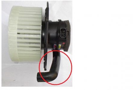

This tube attached to the blower motor called "blower motor cooling tube"
https://images.2carpros.com/forum/automotive_pictures/46384_0900c152800cc50e_3.jpg
it connected to blower housing. you need it on the blower if you have AC.(check your email for this diagram) it cost around $ 6.50. (auto part or auto zone/. take the remaining as seen in your pic , get a new one, it slide in the housing.(lubricate the end with engine oil to make it slid easily in the housing) you will see when you get a new one, pretty easy. look like this :
https://images.2carpros.com/forum/automotive_pictures/46384_Blower_Motor_Cooling_Tube_1.jpg
