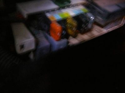

Yesterday my a/c wouldn't turn off on my car, even after I turned off the car. After a slight electrical burn smell on my way home, it shut down last night. But this morning, again it wouldn't shut off once I started the car. Had to disconnect the battery. Other replies say to replace the a/c relay switch that's located by the firewall. Problem is I'm a woman and not all that familiar with this, and need pictures or a better description for what I'm looking for. Is the relay box on the bottom of the cruise control box under the hood? What exactly should I order from the parts dealer? Is this an easy plug in part? Does anyone have a picture of what the relay box area looks like?

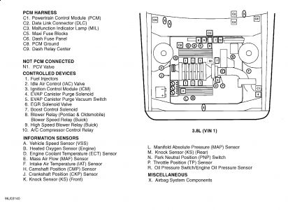

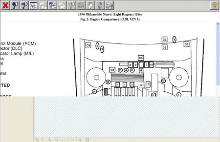

Hi there sandy2nm and TY for the donation this is what keeps the site going. The blower motor relay is on right side of firewall position no. 8 below -swap or replace this relay and tell me what happened

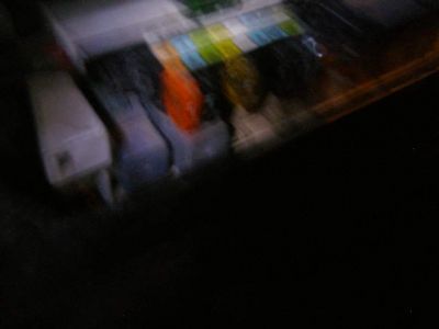

I tried to pull out the box that's located underneath the large fuses under the hood. I got the second one loose, but both boxes have wires attached behind the box (2 red, 2 green). So I decided I'd better check to see if this is in fact the relay switch before I go any further. I did, however, pull the large fuse in this area that goes to the AC. So at least I can now shut the car off and not have to disconnect the battery to get the AC fan to go off. I'm submitting a couple of pictures (sorry about the blur and the night time pictures). You can see the box that I've pulled loose from the holder (under the red colored fuse). Am I going for the right part?
Let me reverify this are we talking about the blower motor fan or the AC condenser fan??
Underneath that red fuse is for the high speed blower motor relay for a buick left of it is the blower motor relay for an olds and pontiac

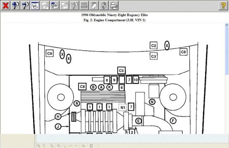

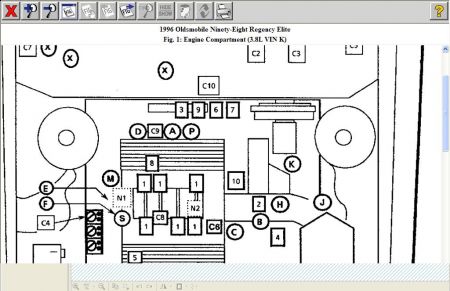

VIN K The AC compressor is at no.3 and VIN 1 is at no. 10
https://images.2carpros.com/forum/automotive_pictures/12900_ac_VIN_K_1.jpg
https://images.2carpros.com/forum/automotive_pictures/12900_ac_VIN_1_1.jpg
If it continues to run-get the HVAC control assy and the computer checked out to include the blower control switch-You have a dead short somewhere within the AC circuitry.
