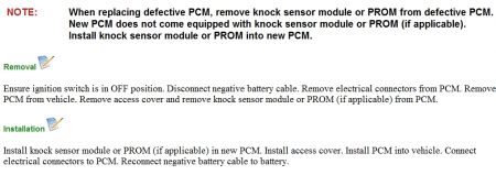

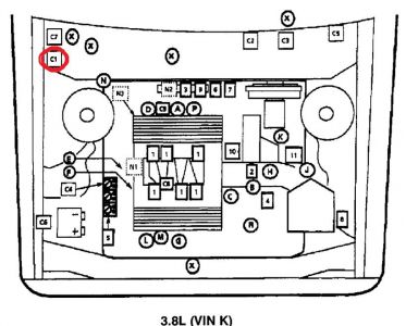

Ok so I did what you said and I didn't junk the car. I bought a used ECU. Now I need to know where it is located in my car so I can replace it. Are there any tricks that I need to know about or any special instructions? Please advise.

BLUELIGHTNIN6
  • 16,542 POSTS
i'll need the 8th digit of your VIN so I can get the correct location

The 8th digit is K

BLUELIGHTNIN6
  • 16,542 POSTS
thanks, your PCM is behind the right side of the dash , pic below.
https://images.2carpros.com/forum/automotive_pictures/261618_Noname2_842.jpg
