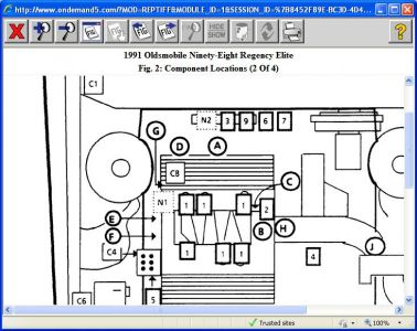

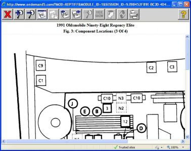

Where is the compressor clutch control relay located? Under the hood or under the instrument panel?

It's number 3 in the diagram depends if your 8th digit of your vin is a C or L?The first one is if your 8th digit is a C and the second one is if it's a L.
