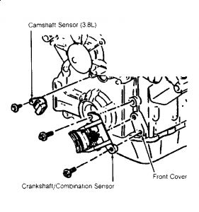

This model only used the 3800 engine. I thought about these but since they are a required signal for the spark and the engine runs fine cold I assume these are okay. I don't have the diagonstic equipment to read the pulse signals, is there an easier way?

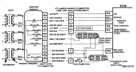

Okay, lets run some tests on the camshaft sensor. Now what I have read the car will run if the signal is bad just not well. It is on the timing cover refure to pic below. Now here is what I need you to do first. Unplug it and hook up your volt meter (on the plug) between term a and b and check voltage and then check voltage between term b and c with key on engine off votage should be between 8-11 volts. Let me know what you find. Also is the engine light on and is there any codes? The first pic below is so you can locate the camshaft sensor. The second pic is so you know what term is what in the sensor harnes so you can test the voltage, if you look in the lower right hand corner of that pic you will see the camshaft sensor plug with the term labeled let me know what you find.
