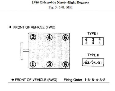

1986 Oldsmobile 98 firing order for plug wires
1986 OLDSMOBILE 98
LOGELL
Engine Mechanical problem
1986 Oldsmobile 98 6 cyl Front Wheel Drive Manual
While replacing heater fan, I unplugged plug wires and now firing order is wrong

https://images.2carpros.com/forum/automotive_pictures/30961_z_1.jpg
