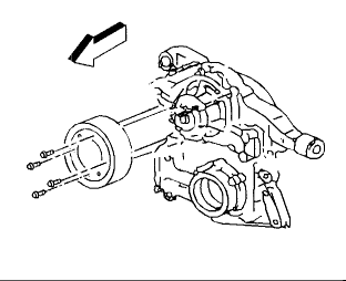

Replace water pump
Jun 12, 2010 at 3:55 AM
  • 75,992 POSTS
Removal Procedure Caution: Refer to Battery Disconnect Caution in Service Precautions. 1.Disconnect the negative battery cable. 2.Drain the coolant. 3.Remove the drive belt.
https://images.2carpros.com/forum/automotive_pictures/12900_wp_4.gif

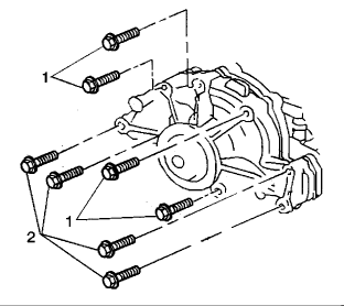

4.Remove the water pump pulley bolts. 5.Remove the water pump pulley. 6.Remove the water pump bolts. 7.Remove the water pump. 8.Clean the gasket mating surfaces. Installation Procedure 1.Using a new gasket, install the water pump on the engine. Notice: Refer to Fastener Notice in Service Precautions.
https://images.2carpros.com/forum/automotive_pictures/12900_wp1_1.gif
2.Install the water pump bolts. **Tighten the bolts (1) to 15 Nm (11 ft. lbs.) . **Tighten the bolts (2) to 30 Nm (22 ft. lbs.) . 3.Install the drive belt. 4.Fill the coolant. 5.Connect the negative battery cable. 6.Check for coolant leaks. https://www.2carpros.com/kpages/auto_repair_manuals_alldata.htm
