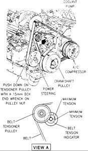

how do you remove and replace the belt tensioner assembly on a 1996 Olds 88, I removed all the bolts but it wont come off.

Hello - Here is the info you requested...........
https://images.2carpros.com/forum/automotive_pictures/248015_42161843_1.jpg
BELT ROUTING Refer to Fig. 25. for serpentine drive belt routing. BELT TENSIONER, REPLACE Disconnect battery ground cable. Drain engine coolant, then remove accessory drive belt, Fig. 25. Remove alternator and heater hoses. Remove tensioner attaching bolts, then the tensioner. Reverse procedure to install.
