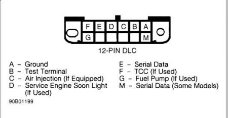

If you have the 12 pin datalink connector, you may be able to access mil codes. You use a jumper wire between terminals A & B of datalink connector, lower edge of dash, usually. You turn the key on, no crank, the mil starts flashing on the dash, you count the flashes to get the codes. Your looking for two digit codes. You need to be sure your obd1 compliant, 95 is crossover year from obd1 to obd2.
https://images.2carpros.com/forum/automotive_pictures/170934_12_pin_datalink_connector_1.jpg
