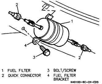

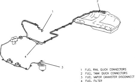

Where is it located?
Thursday, January 14th, 2010 AT 1:37 AM
MECHANIC
75,992 POSTS
Fuel Pipe Routing
Fuel Filter
Area Below Rear Of Engine Compartment
FUEL FILTER LOCATION
The inline fuel filter can be found on the right front body rail under the vehicle.
