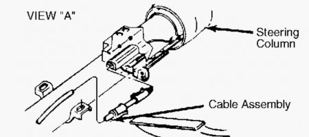

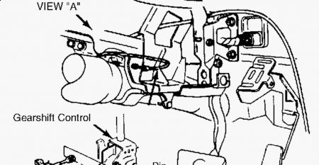

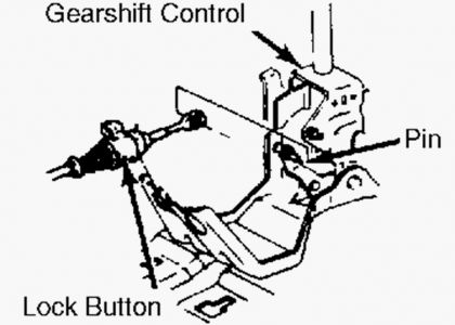

I have a 1993 Oldsmobile 88 Royale that starts just fine, but requires me to heat it up for as long as 10 to 25 minutes before it will shift into gear from park. After that, it drives just fine. This is required every time I start the car up, if it's been turned off for longer than a couple of hours.
I had someone suggest that it might be the sensor, while someone else said it might be the transmission. Any suggestions on what it might be would be great. Thanks.

This is for floor shift models. PARK LOCK CABLE (FLOOR SHIFT) Page 1 of 1 1.With gear selector lever in Park and ignition switch in LOCK position, gear selector lever should not be able to be moved to other gear positions and ignition key should be removable from lock cylinder. 2.With ignition switch in RUN position and gear selector lever in Neutral, ensure ignition switch cannot be turned to LOCK position. If system does not perform as described, unlock park lock cable adjuster (button up). See Fig. 11 . Move cable connector nose rearward until key can be removed from ignition. Lock cable adjuster (button down).
