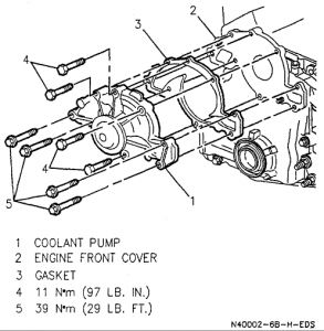

Where is the water pump located on this vehicle?

Water Pump
