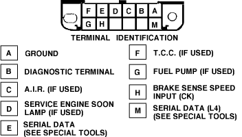

I will do my best to shed some light, first of all let's see what the check engine light is coming on for. You can do this at the diagnostic connector with the procedure that follows.
https://images.2carpros.com/forum/automotive_pictures/309872_41916214_1.gif
ALDL Connector PROCEDURE: Turn the ignition to the "ON" or "RUN" position (engine off). Make a note of the "SERVICE ENGINE SOON" light. Light should come on steady. If there is no light or the light flashes, do not proceed with remainder of test. Results of test will be invalid. Turn the key on to the "RUN" position (engine off). Ground the diagnostic terminal (ALDL terminal A to B). The "SERVICE ENGINE SOON" ("CHECK ENGINE") light should flash a code 12. This is displayed, on the Check Engine light, by 1 flash followed by a short pause then 2 flashes. This should repeat 3 times. A code 12 should always flash when an on-board diagnostic check is performed. Any other codes, stored in the computer (PCM), will follow a code 12. If you can, see what the charge output is when the high voltage message is displayed, is it truly high? I have not found what the threshold is for it to be considered high voltage, but I would speculate anything over 15 volts. If it is not high, then we may remove the brown wire from the generator connector to simulate the switch in the generator being open. If the light is still on, then we could have a circuit fault. I usually visit this site once a day in the evenings, but I will check for your reply.
