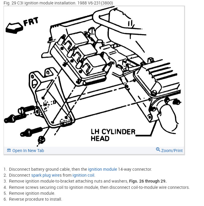

i have just put in a crank sensor in my car and it gets no spark but it will crank all day long. i drove it for about an hour turned it off to get some gas then it didnt want to start back up so i put her on a trailer and took her home. the next day it started and i drove it off the trailer. that is when i changed the crank sensor. and no it still wont start my wires and plugs are good and i have a new battary in it. i am in the need of some help please.

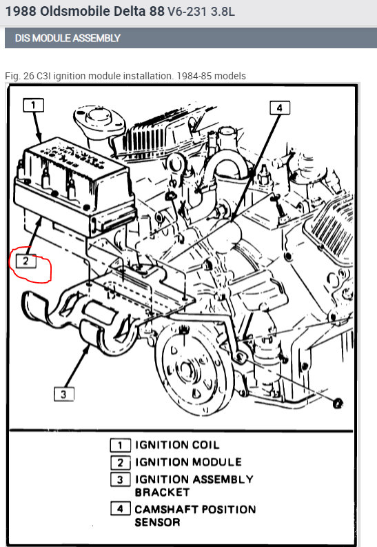

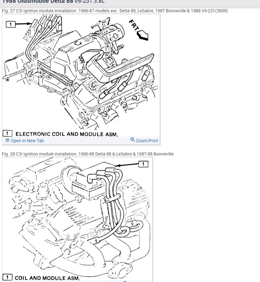

This no spark could be due to a bad ignition control module. The ignition control module is located under the ignition coil (see diagram).
Faulty module can trigger no spark.
These modules can be tested. The best option is to remove it and take it to your local auto parts store. They have testers that can be utilized to see if the module is bad.
