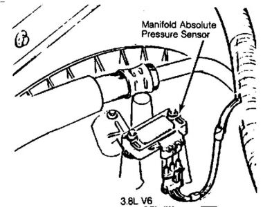

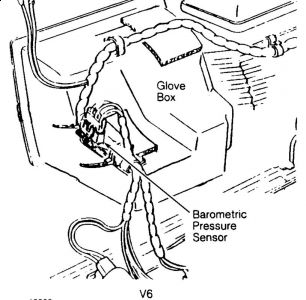

Code 32 is barometric pressure sensor low output. Is there a way to solve this problem? If I need to change it where is it located? What effect does it have on driveabillty? Is there a diagram that shows where all the sensors are located ? please help thanks.

32 is EGR or MAP sensor voltage low, could be either, check for stuck egr, or carbon deposits holding pintle open, check vacuum source for bothe EGR and MAP sensors.
https://images.2carpros.com/forum/automotive_pictures/62217_Baro_1.jpg
https://images.2carpros.com/forum/automotive_pictures/62217_MAP_2.jpg
And is yours rear wheel or front wheel drive?

The car that I asked about Is a V8 With a carburated engine .I checked that area and didn't see it and it is rear wheel drive.

On yours, the code 32 is for the EGR, not fuel injected= no Baro!
