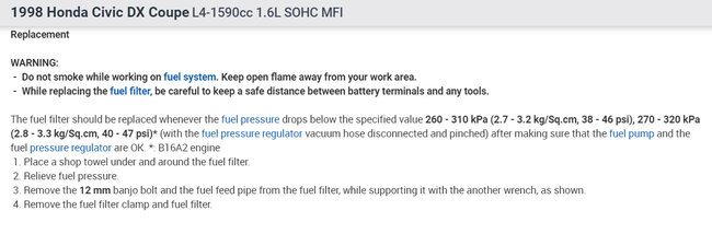

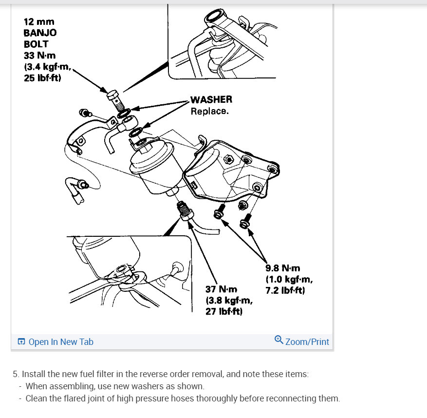

It is best to drain the old fuel out before installing new fuel to be safe, here is a video on how to siphon the tank to help you with your car. Also, I would change out the fuel filter.
https://youtu.be/Q5MH2gnyFH0
Check out the images (below). Please let us know if you need anything else to get the problem fixed.
