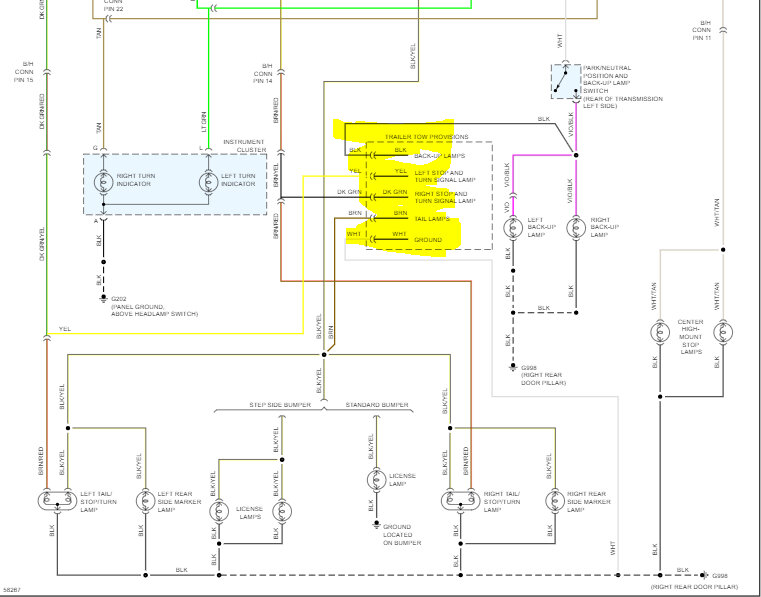

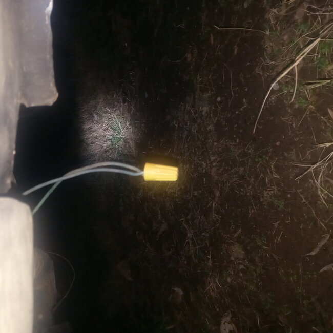

By the hitch and on the passenger rear green, blue, yellow, and black wires with no connection like someone cut them? Is there a diagram for this?
Dec 2, 2022 at 2:41 AM
  • 110,248 POSTS

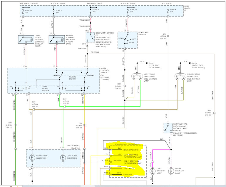

Black is the reverse lamps, yellow is for the left signal and stop lamp, and dark green is for the right-side signal and stop lamp.
I am not seeing a blue wire. There should be a white wire for ground and a brown wire for the parking lamps.
I attached the entire exterior lighting circuits below. See pics 1 and 2. I also zoomed in on the trailer wiring in pic 3. Confirm there is a blue wire. If there is, turn the parking lamps on and see if there is power to it which turns off when the lamps are turned off.
