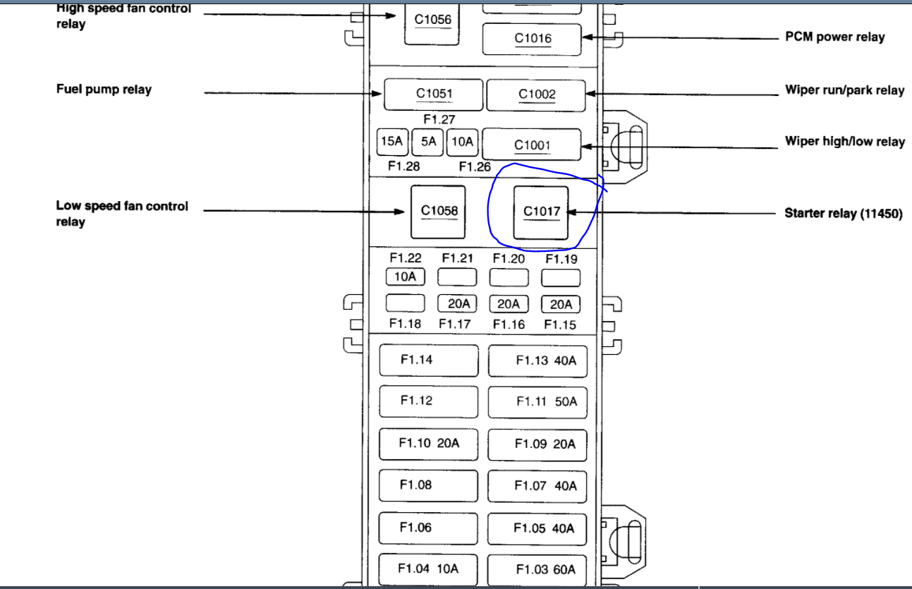

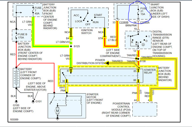

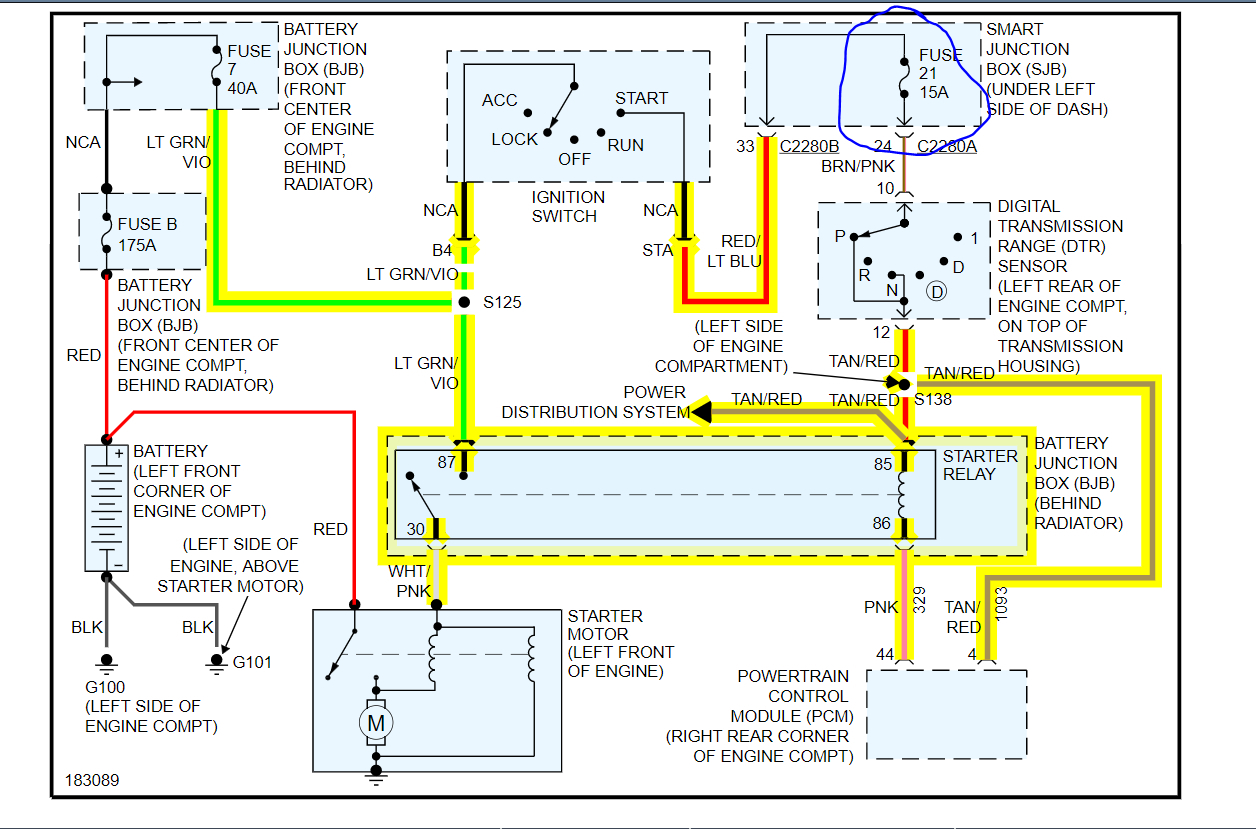

Okay, I change the alternator and brand new battery and my car still wont start.
Thursday, December 17th, 2020 AT 5:22 PM
MECHANIC
52,797 POSTS
Good evening,
Does the engine crank over at all?
I attached a wiring diagram of the starter system for you to view. If you have a voltmeter, we need to do some checks.
Can you hear the fuel pump run with the key on?
