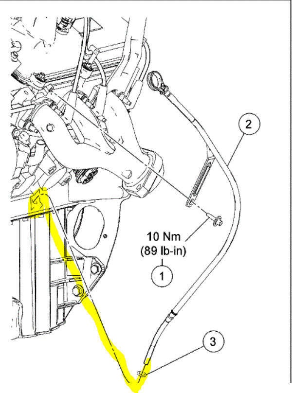

can't find the oil stick or possible hole for one.

It should be on the driver's side of the engine about two thirds back on the engine block. See pic below. If you still don't see it, check on the engine block itself to confirm it isn't broken. These were known to rust into the tube and when removed, they would break.
See pic below.
