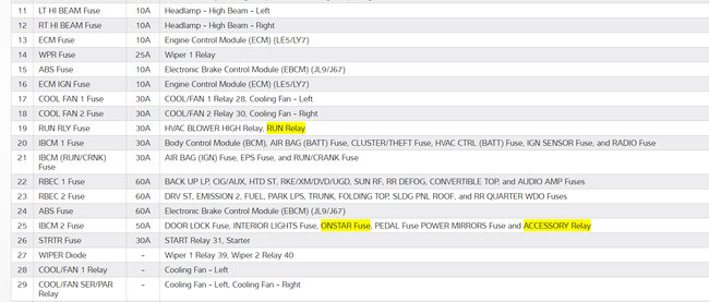

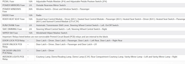

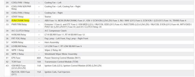

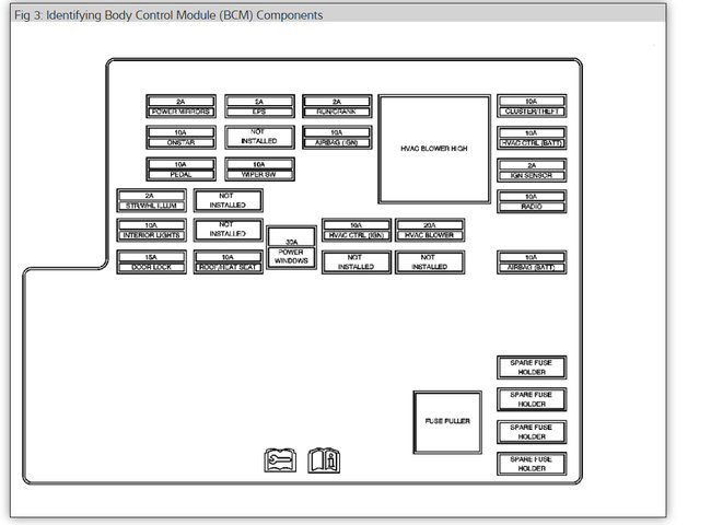

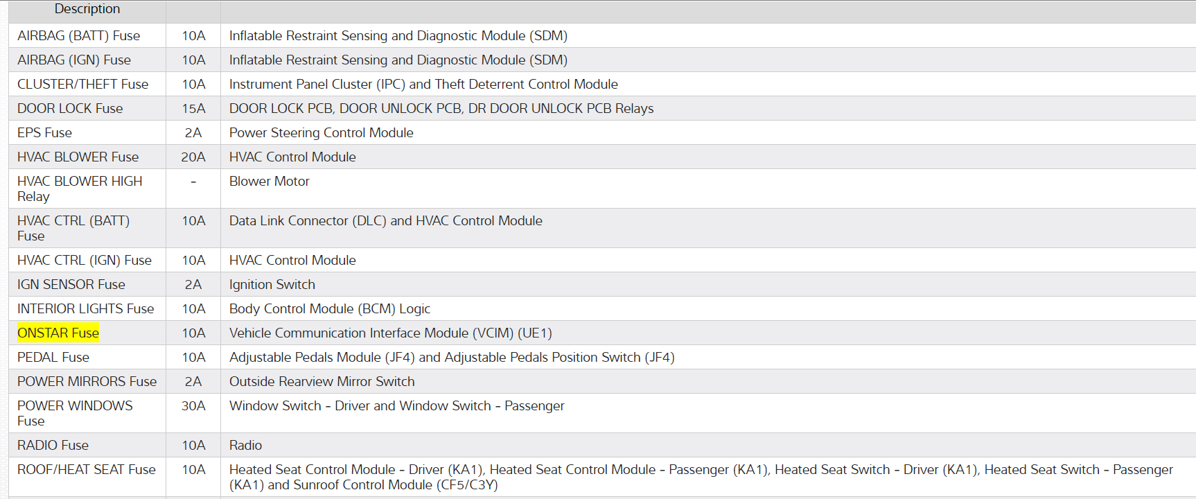

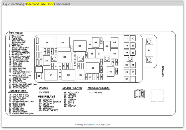

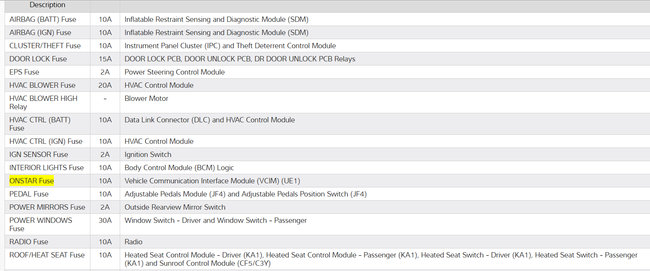

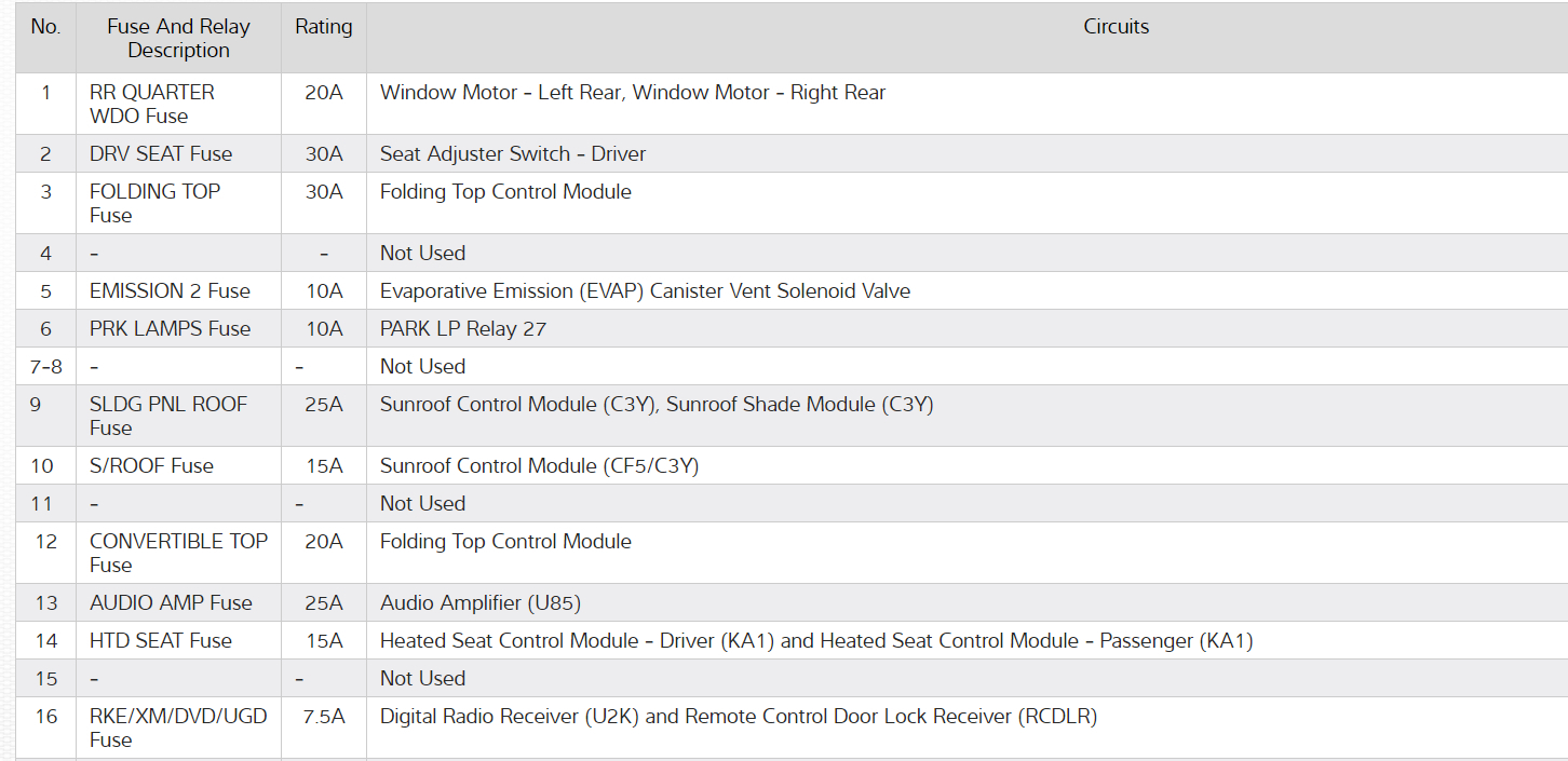

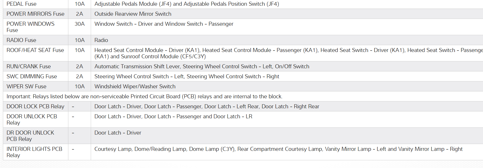

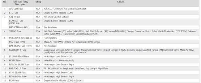

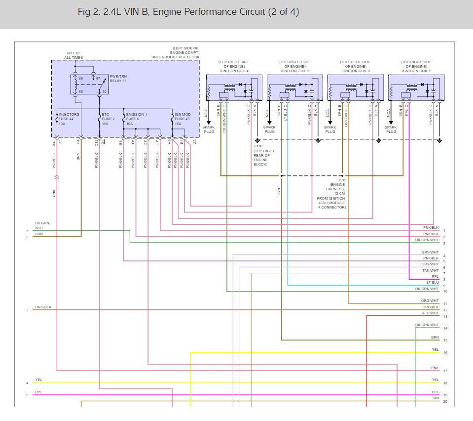

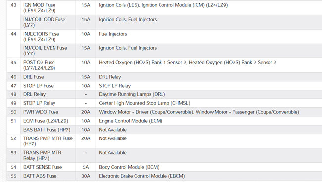

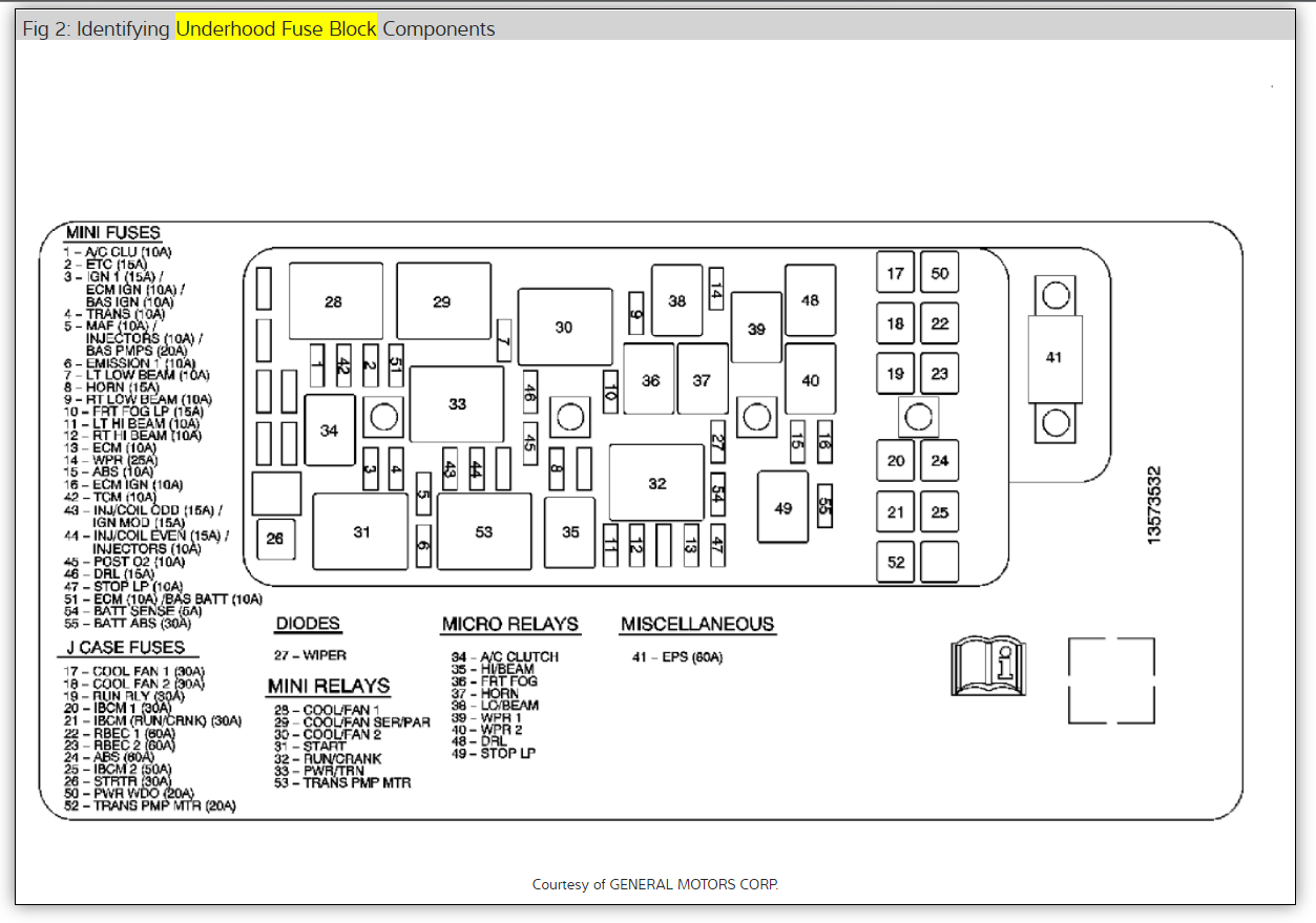

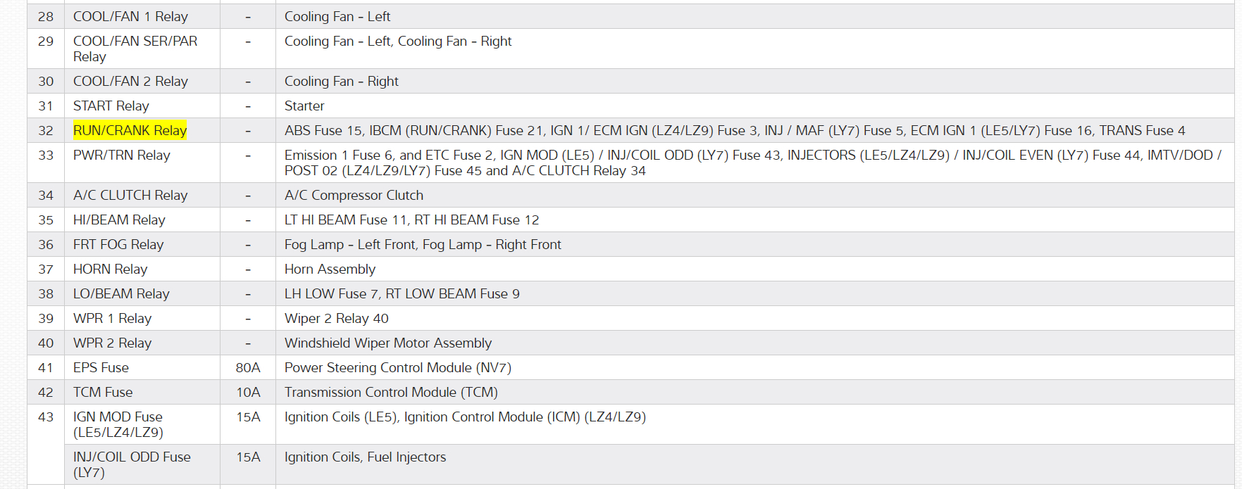

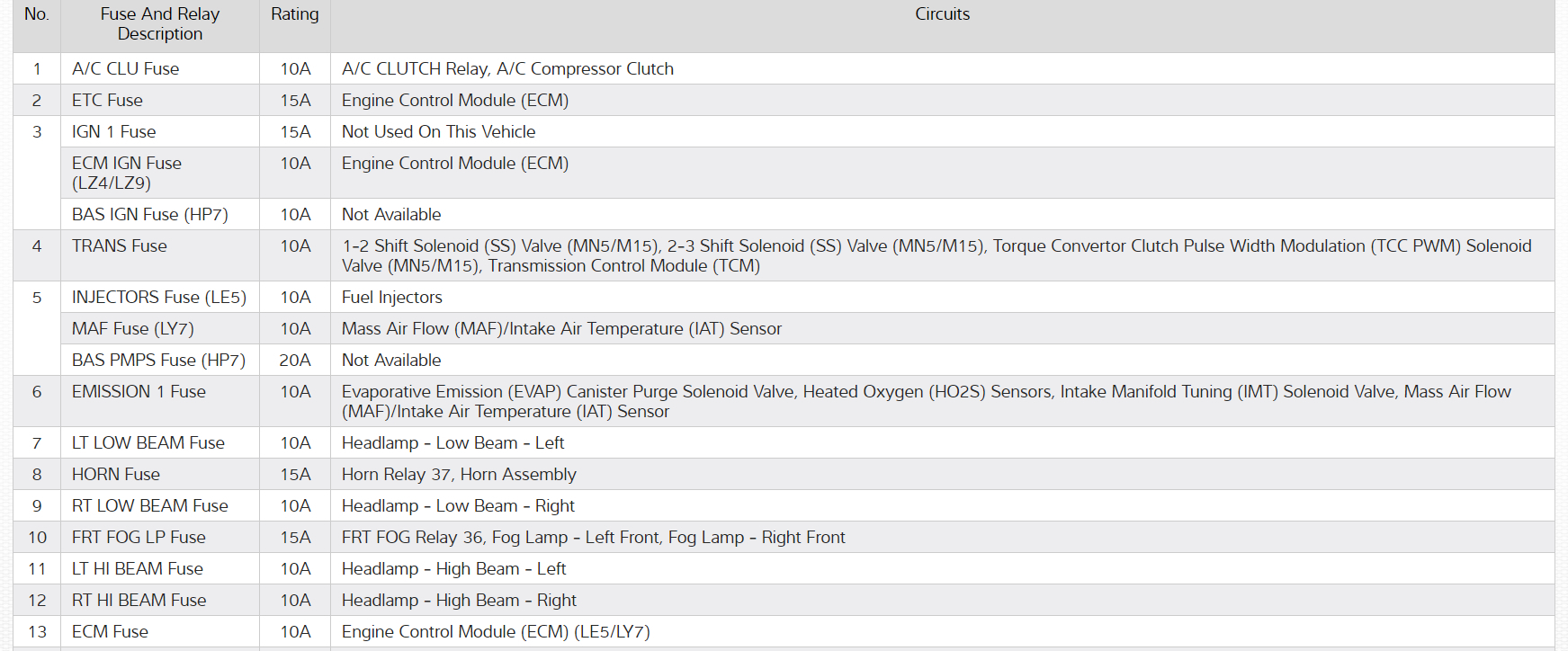

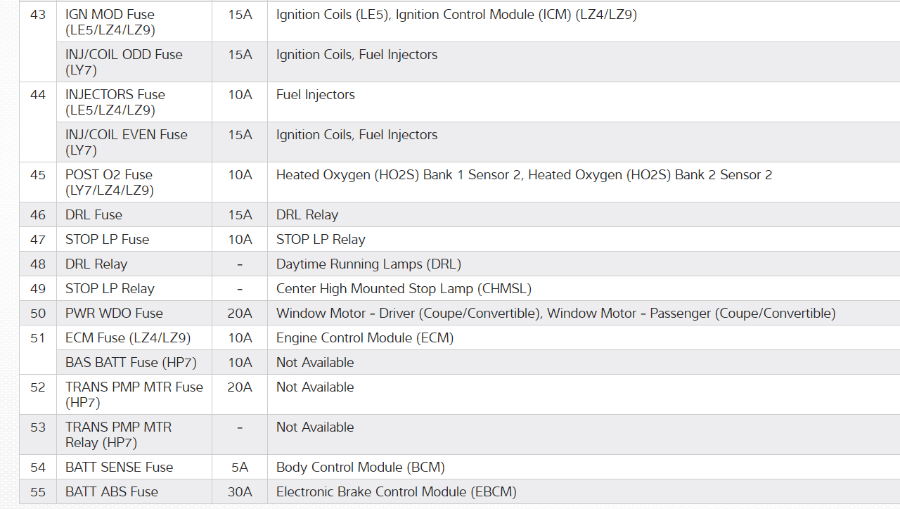

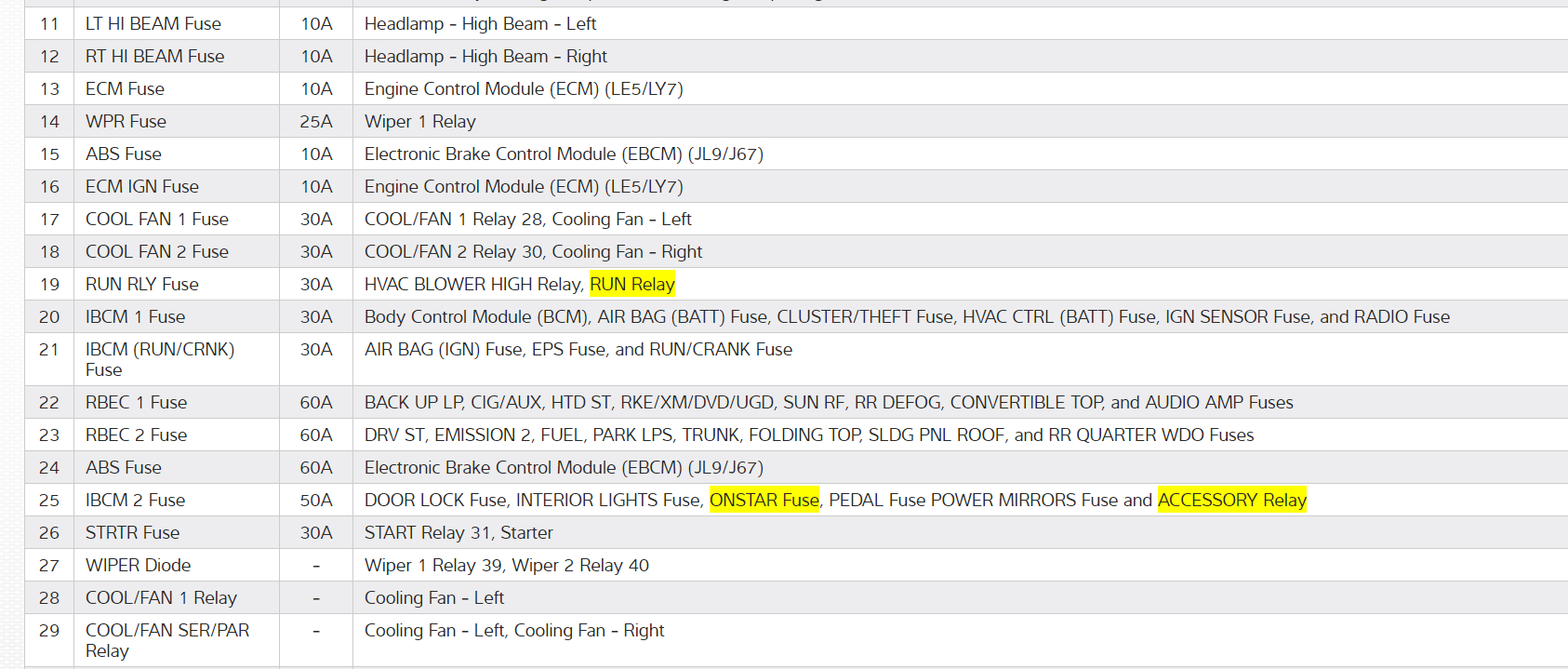

There is a power train control relay that powers the ignition coils for you car which I think has gone bad but we should run the codes first.
If no codes come up lets test the relay.
Also check all fuses.
Please run some tests and get back to us.
Feb 12, 2018 at 6:47 AM
LINDSAY LOOMIS

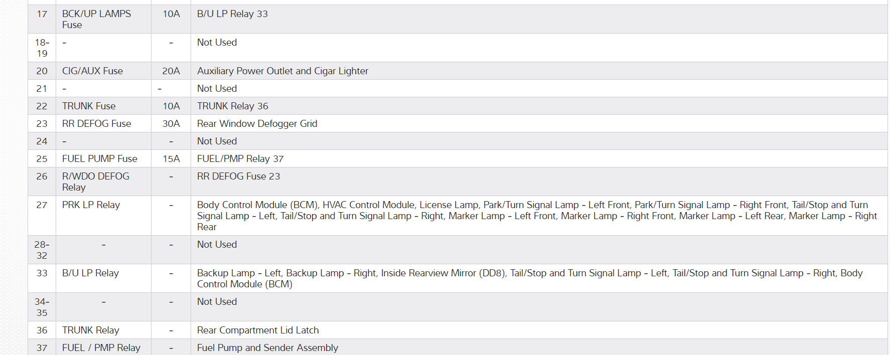

Fuses are all good. No codes came up but I was not expecting any either. I have had this issue since September of last year. Every time it shuts off while driving (twenty five to fifty seven mph) and when it gets towed, no codes ever come up. When they replaced the computer in November we have not had a single problem until yesterday. After checking the relay (which was clean, looks new, lit up, clicked) it sat overnight. Went to try it this morning and it started up for about five seconds.
Feb 13, 2018 at 9:24 AM
Good morning.
The first thing I would do is check the fuel pressure. Need to be sure the pressure is correct.
you can rent a tester at a parts store is you do not have one.

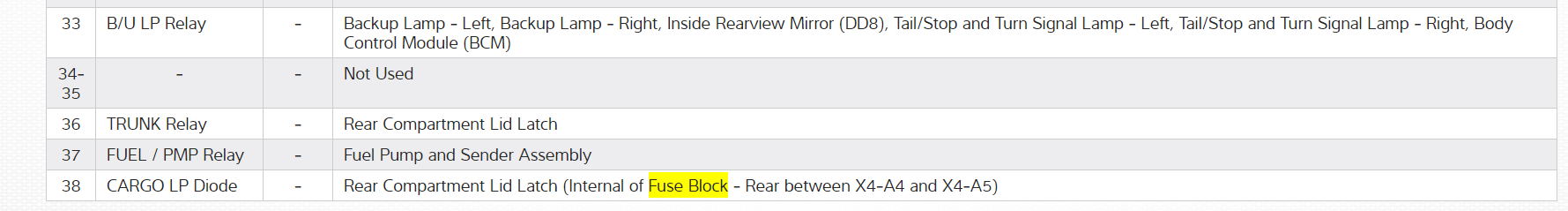

Feb 13, 2018 at 4:30 PM
  • 55,273 POSTS
Here is a guide to help you see what you are in for when doing the job:
If the fuel pump fails it loses pressure causing the spray to be minimal which does not ignite this is where the fuel smell comes from.
