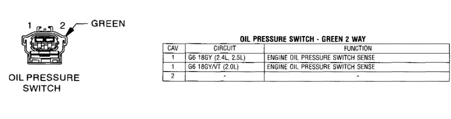

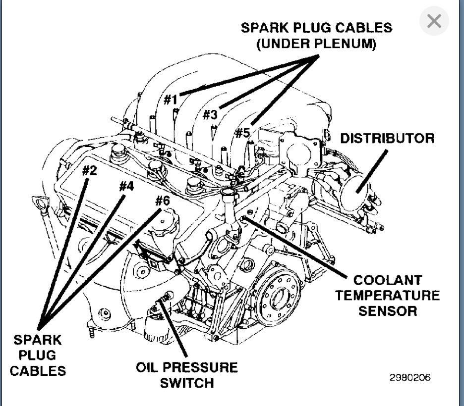

Where is the oil sensor or a regulator located?
Sep 17, 2018 at 8:48 AM
Experienced Mechanic
18,907 POSTS
I am attaching the information requested below.
Here are a couple guides that will help with oil pressure issues:
https://www.2carpros.com/articles/high-or-low-engine-oil-pressure
https://www.2carpros.com/articles/high-oil-pressure
Run through this material and let us know what you find. Thanks
