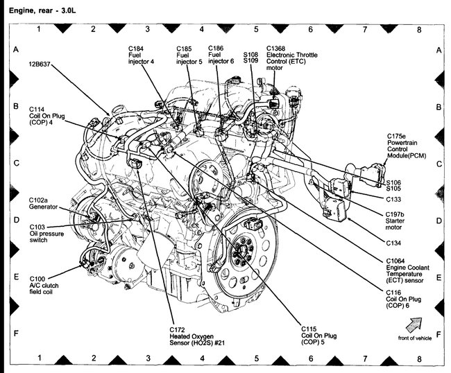

Looking for location of oil pressure sensor?
2006 LINCOLN ZEPHYR
150,000 MILES • 3.0L • 6 CYL • 2WD • AUTOMATIC
CHRISTO?
looking for location of oil pressure sensor?
Nov 16, 2017 at 8:19 PM
PATENTED_REPAIR_PRO
  • 1,853 POSTS
Left hand side of engine block, near the oil filter. Here is a diagram of its location at D-1. Check out the diagrams (Below). Please let us know if you need anything else to get the problem fixed.
