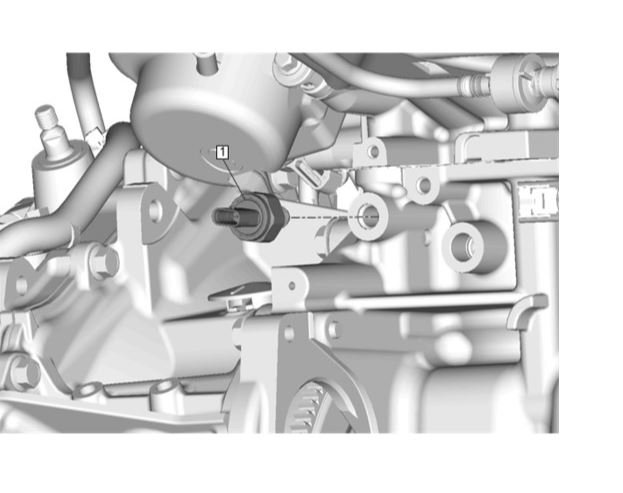

Good afternoon.
You did not list the engine size so I attached a picture of both the 1.5 and the 2.0.
The switch is out in the open and is accessed from the bottom of the car looking up.

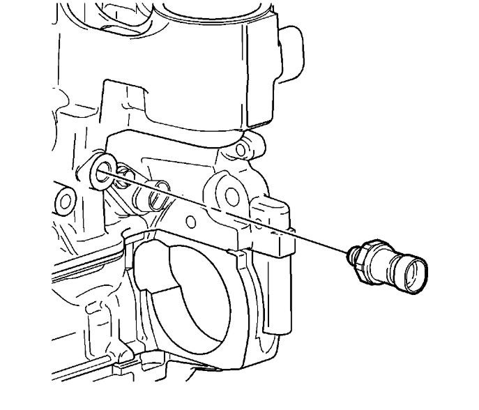

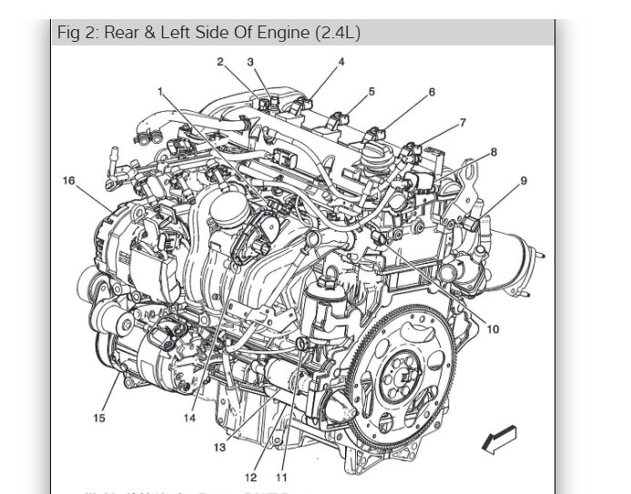

Got this from Alldata.Check out the diagrams (Below). Please let us know if you need anything else to get the problem fixed. The Medic

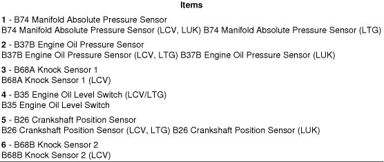

The oil pressure sensor is item #2 tucked behind the intake on the rear of the engine. Check out the diagrams (Below). Please let us know if you need anything else to get the problem fixed.

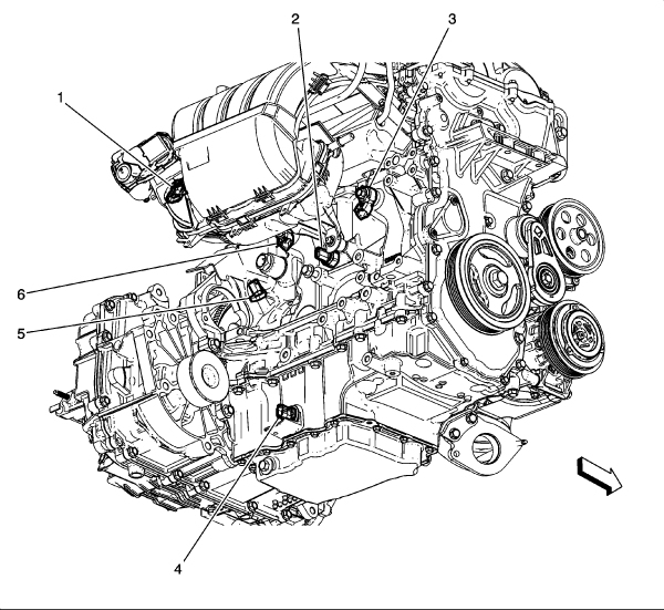

SCGRANTURISMO
  • 4,897 POSTS
I have included the information that you requested in the diagrams down below. It is located right in back of the oil filter. Please, if you have any other vehicle related questions, feel free to ask.

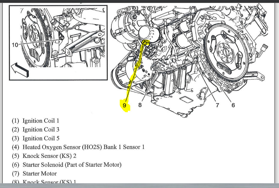

DONNA MCCARTHY
Where is it located and what does it look like?
Sep 7, 2020 at 7:07 AM (Merged)

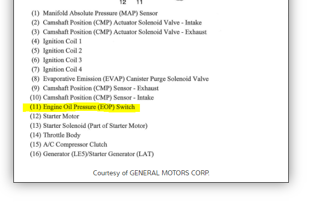

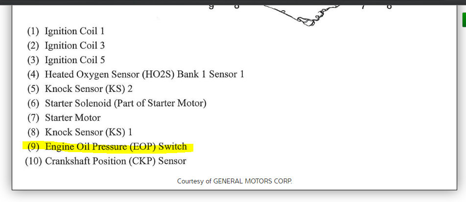

SCGRANTURISMO
  • 4,897 POSTS
I have included a diagram of your vehicle's engine and all of the switches and sensors on it. The Oil Pressure Switch(OPS) is number 11 on the diagram. Please get back to us with how everything turns out.

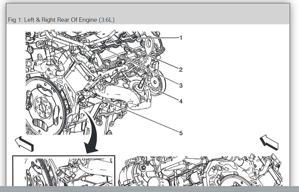

GAR67
i have a leak that is coming from above the oil filter housing. i changed the oil pressure switch, but that did not help.
i am thinking about changing the oil filter. i am not sure that would help. just going about the least expensive
way. the leak seems to be coming from the engine above the filter. could this be valve cover gaskets.
my engine is v6 3.6l

possible but the pressure switch is more suspect
GAR67
even though the oil pressure switch has been changed?
make sure it is not leaking from there. it is common when installing that you can break the plastic top on installation/

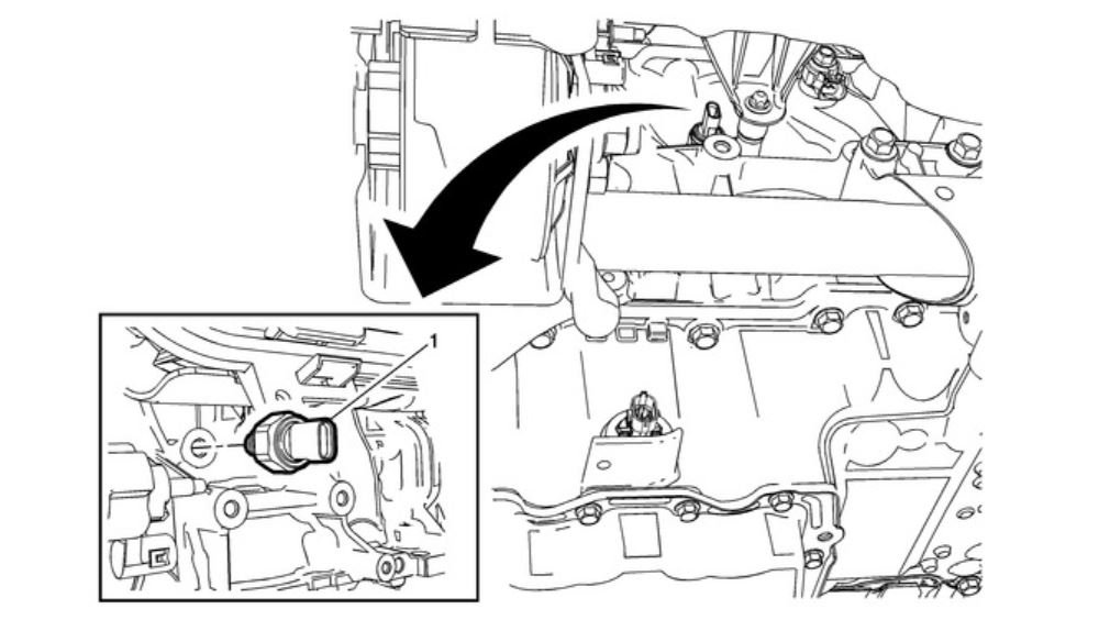

Good afternoon,
The sensor is above the oil filter. I attached two pictures for you to view.
Removal Procedure
1. Remove the starter. Refer to Starter Motor Replacement (LZ4) Starter Motor Replacement (LAT) Starter Motor Replacement (LY7) .
2. Disconnect the engine wiring harness electrical connector (2) from the oil pressure sensor.
3. Remove the engine oil pressure sensor.

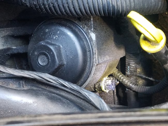

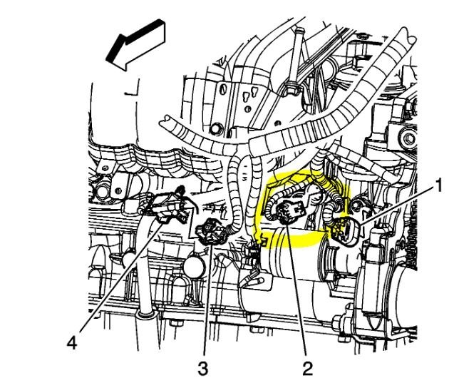

STEPHANI JOHNSON MCDANIELS
  • 5 POSTS
Is this the sensor?
  • 5 POSTS
The sensor that I need to replace is slightly below and to the left of the oil filter. I'm being told that is the oil pressure sensor but I need confirmation.
Do you have a new sensor? If you do, remove the connector from the sensor in the picture and make sure it fits on the new sensor. That will confirm it.
  • 5 POSTS
It's on it's way here now.
  • 5 POSTS
I replaced the sensor.. which was not super fun and it's a whole lot better. My rpm gauge has stopped working and now it's working again. it smoked a little bit when I started it the first time but that was it. It still had a second of delay to start but that is a whole lot better than it was. Thank you so much for your help. I think replacing the starter is next just to be on the safe side.
