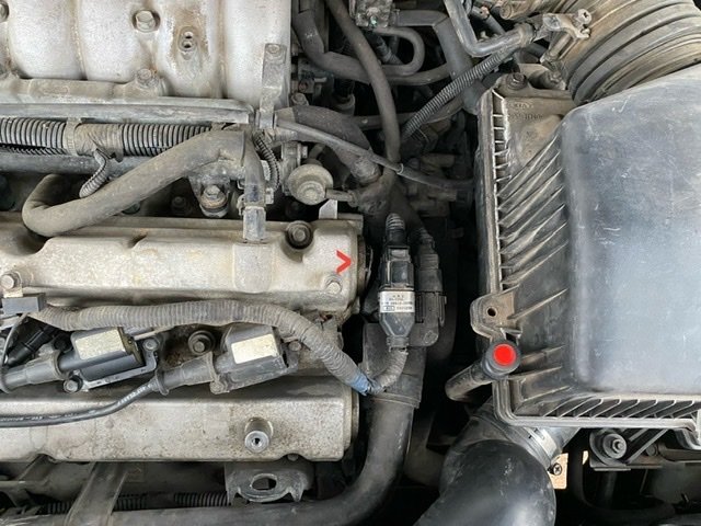

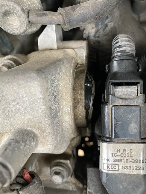

On the driver side of engine of my car, a solid seal has partially dislodged causing major oil leak. I do not know the name of the part. Can you tell me the name of the seal and how to replace it? What would cause it to dislodge?

It is a little hard to make that out. Can you get a little further back so we can get a better prospective? It is just hard to orient where that is. Thanks
Feb 22, 2020 at 8:21 AM
CROWFRIEND
Here:
Feb 22, 2020 at 8:42 AM

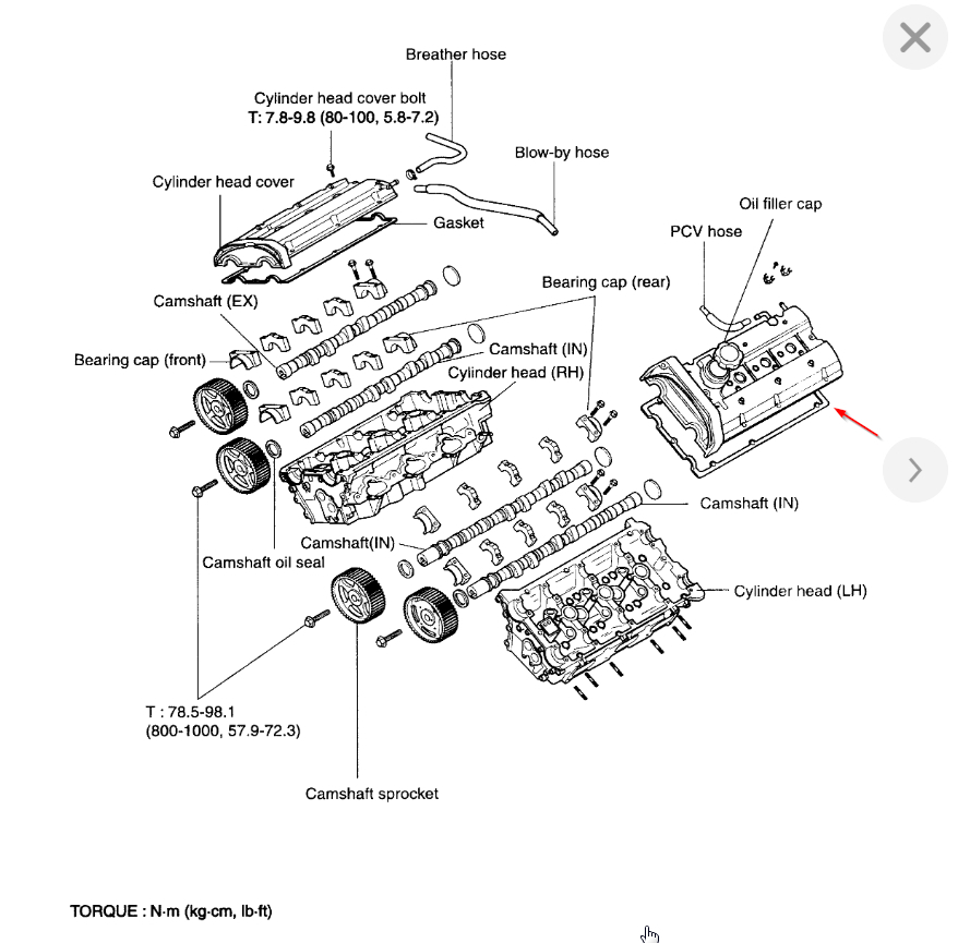

Based on where that is, it is the valve cover/cylinder head cover. The only think that gives me pause is I have never seen one push out like that. However, there is nothing else on that side of the engine that would do this so I would remove the cover and replace this gasket. Plus once you remove it you will be able to see if anything appears to have caused it.

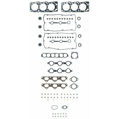

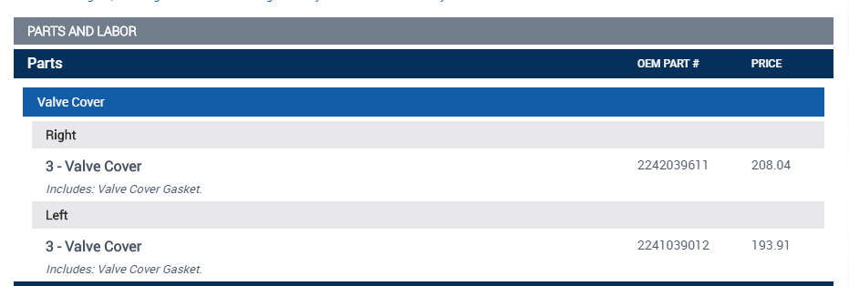

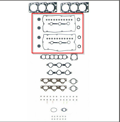

When I search valve cover gaskets they do not include the round seals. They only appear in a complete gasket set.
Feb 22, 2020 at 10:19 AM

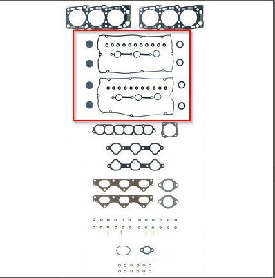

I have not done this on this specific vehicle but have on other Kia's. You are going to need the gaskets circled. If you can't find a kit with just these, then having the head gaskets and other seals is not a bad thing if you plan on keeping this vehicle and work on it yourself. Just keep them in a flat dry place and they will be good for whenever you need them.

Apparently they are called “circular cam plugs”.
Feb 22, 2020 at 11:00 AM
Okay. That is a pretty fitting name as it describes them pretty accurately. You have to remove the actual valve cover to access the plug portion. It basically seals the ends of the camshaft to the valve cover and cylinder head. The ones on the other end should have holes in the middle and not be a solid "plug" because that is where the sprocket attaches to the camshaft.
