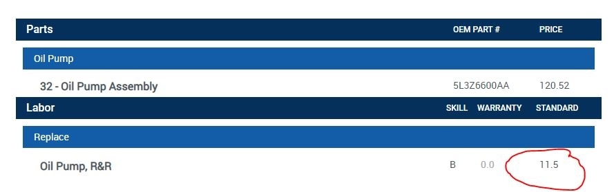

I’m wondering if either the sending unit, or the pump is going bad, due to low oil pressure at stopping, and knocking that it’s getting worse, usually only is noticed at idle, but I’m wondering if the procedure is similar to the question I posted below, the one posted below is a 2 wheel drive. same engine, where is mine is a four-wheel-drive. My understanding is it’s a pretty big job, and requires special tools to replace the pump. I don’t know about the sending unit. I’m wondering if it’s even worth spending $1,800.00 or more, on the whole procedure plus timing chain replacement, or say the heck with it, and find another used vehicle. I’ve already spent upwards of $3,000.00, on a brand new transmission! But I’m wondering If what the shop quoted me is accurate. thoughts?

The price is spot on. It is a big job but what concerns me is the noise. It is not the sender unit. That will not cause a knock of any kind from low pressure. The sender just measures the pressure. It does not control it.
https://www.2carpros.com/articles/high-or-low-engine-oil-pressure
The other thing is the knock. When it knocks, it does bearing damage to the main and rod bearings. This repair is going to be more than just an oil pump.
https://www.2carpros.com/articles/engine-noises
My suggestion is a good used motor. You could get one and have it installed for $1,800.00 you were quoted for the repair.
