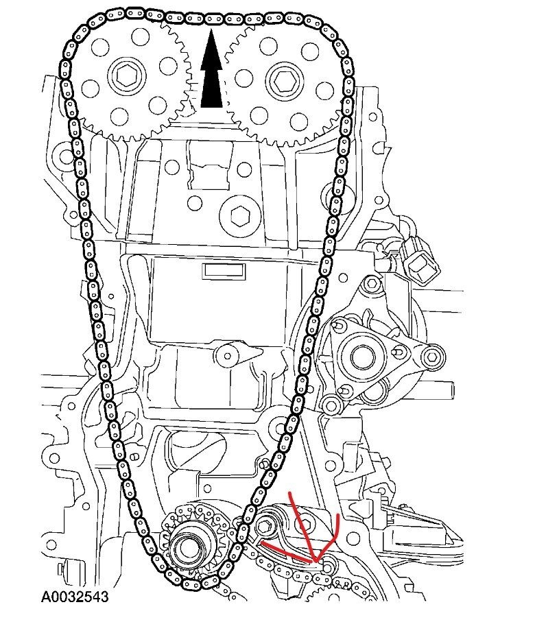

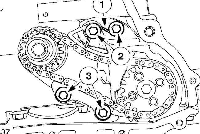

Where is the oil pump located?
103,000 MILES • 2.3L • 4 CYL • 2WD • MANUAL
TIMMYTWOSTEP2
I'm trying to find out where the oil pump is located on the car listed above i can't find any parts diagram on the Internet and I've asked a couple different AI agents and it tells me different thing each time. Is it located in the oil pan or on the side of the motor near the timing chain?
May 26, 2025 at 3:55 AM
STEVE W.
  • 15,421 POSTS
It is in the left front side of the engine driven with a chain from the crankshaft.
