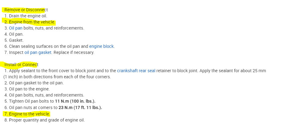

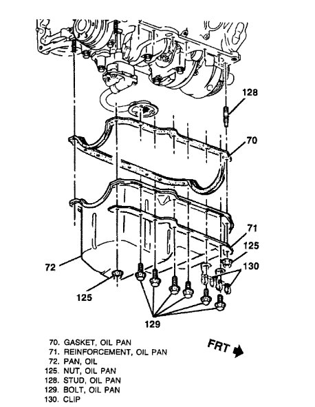

how do i remove the oil pan and pump got it unbolted but cannot get it out.
Aug 4, 2023 at 12:42 PM
  • 110,194 POSTS

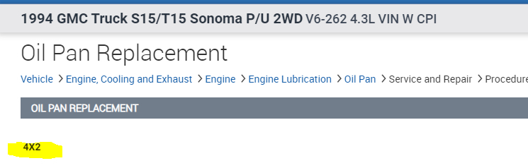

If this is a 2wd, believe it or not, the manual is telling me to remove the engine. I attached the directions below.
Are you able to lift the engine enough to remove it? What is it hitting that prevents you from removing it? Let me know.
Also, I attached the directions below. Take a look at them and let me know your thoughts.
