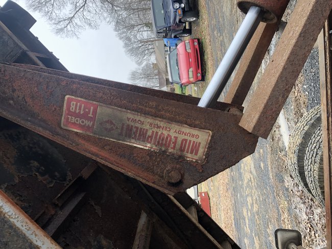

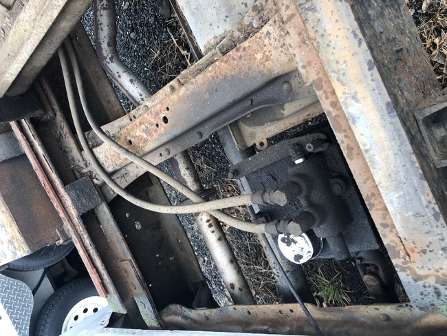

I had a f350 is really old so I m try to find any information of how to change the oil to the cylinder of the bed lifter is a dump truck, I had never change one before if I can get the instructions or a video that show Wells it will be great. I added 2 photos of the cylinder and the pump itself.

Changing that pump should be straight forward. my question to you is, have you checked to see if it has a filter? because if it doesn't I would highly recommend installing one, if it does I would change it before I changed the pump. I also would change the fluid before changing the pump as hydraulic fluid will get water in it over time and make the pump appear to be weak. I hope this has been helpful and thank you for using 2CarPros.
