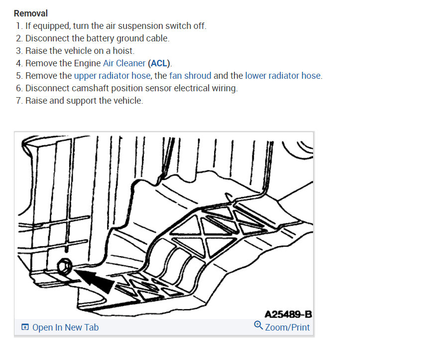

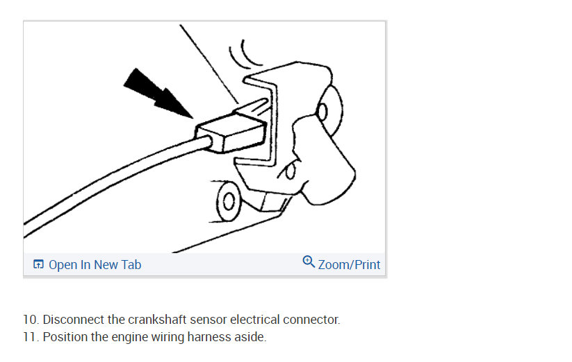

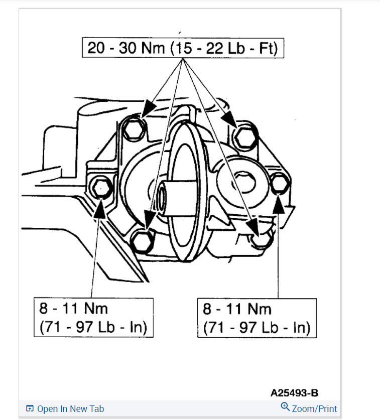

Where is the oil pump, is it in the pan, and how hard is it to change?
Apr 27, 2021 at 4:36 AM
Good afternoon,

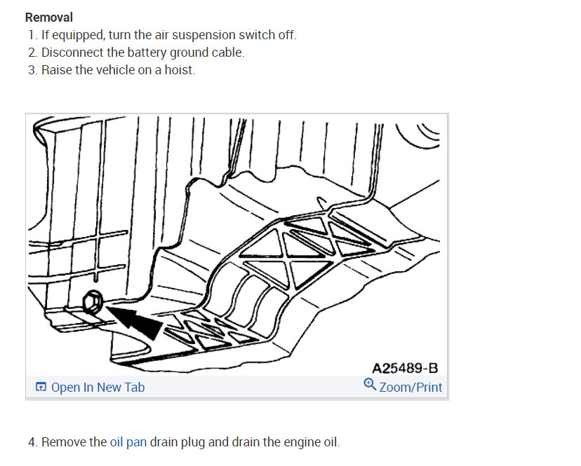

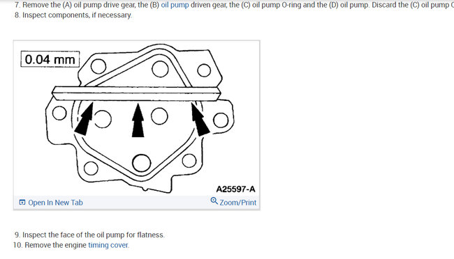

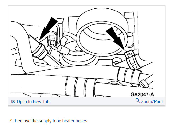

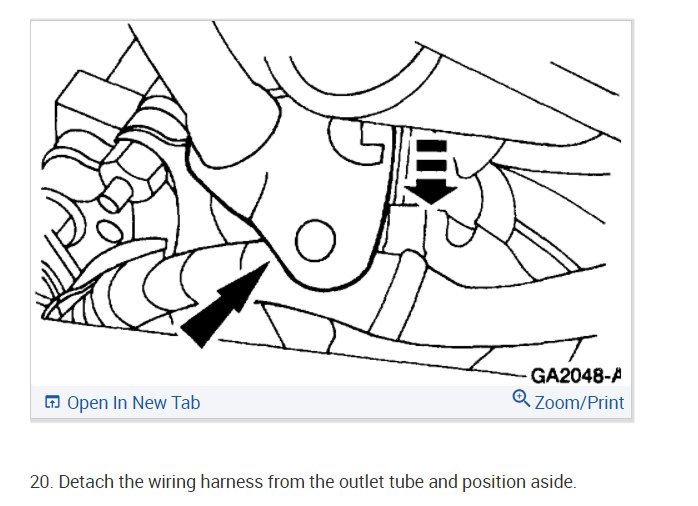

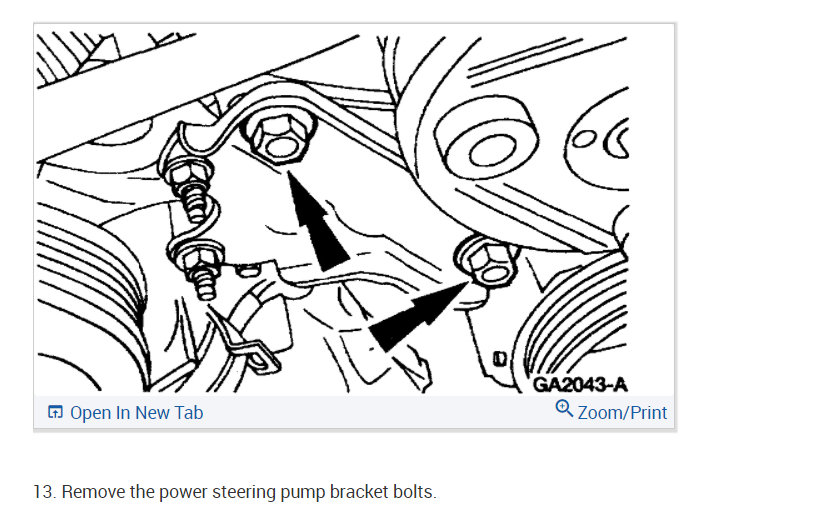

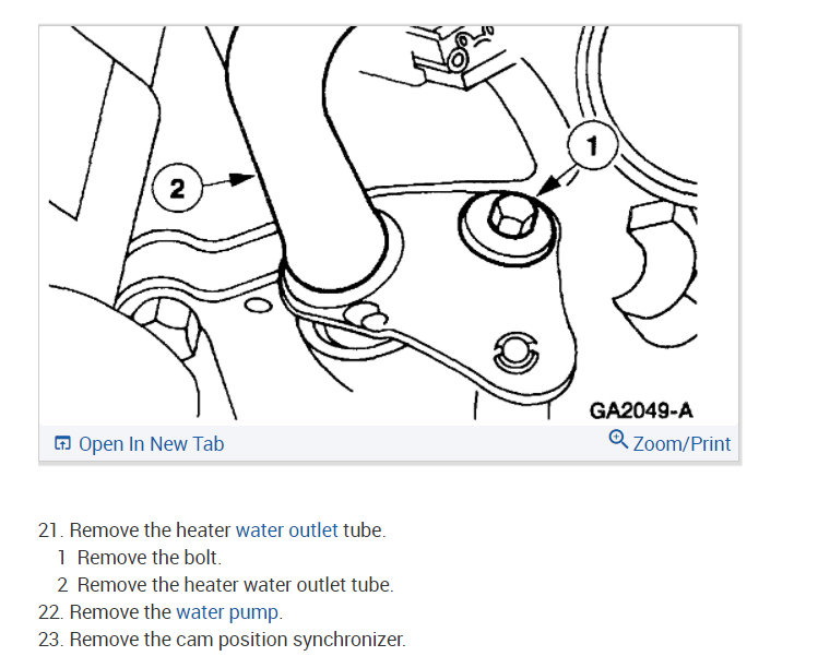

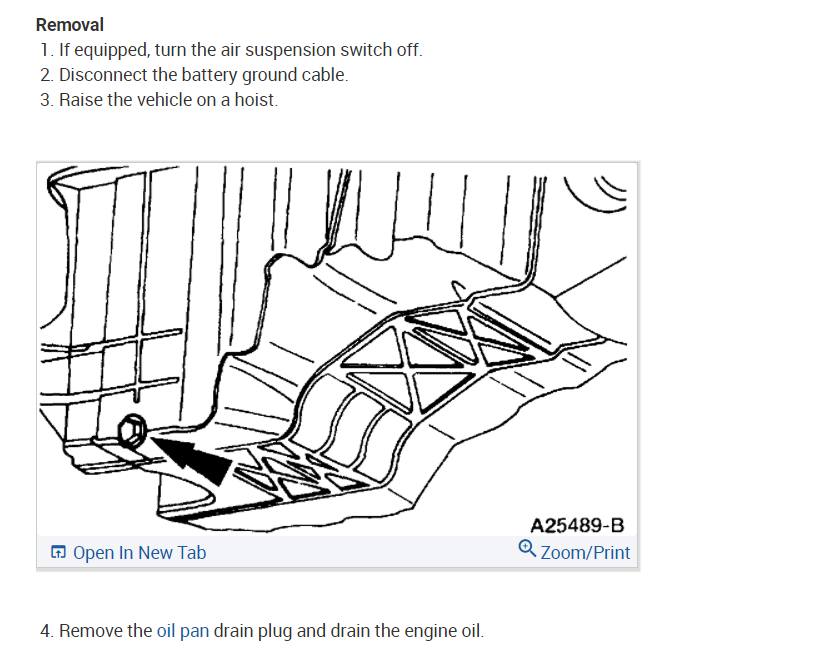

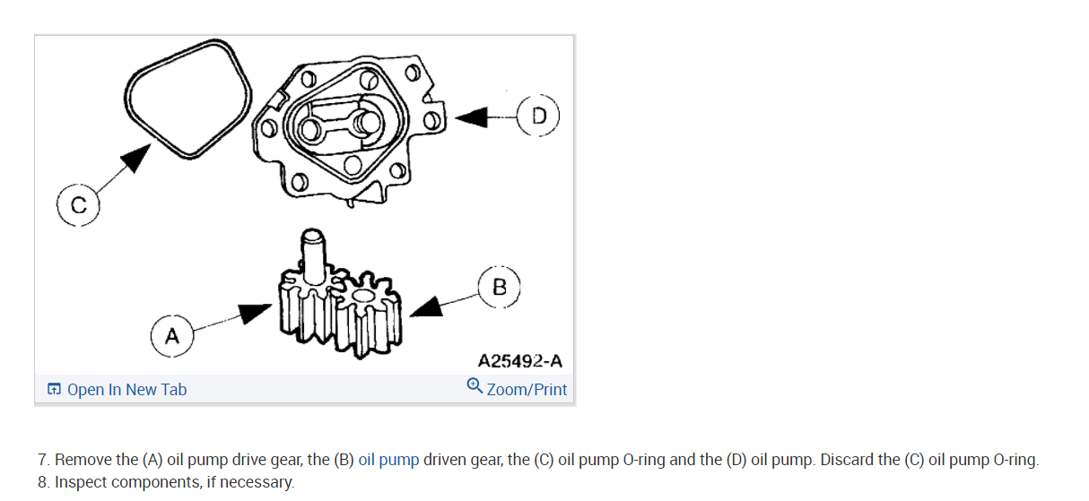

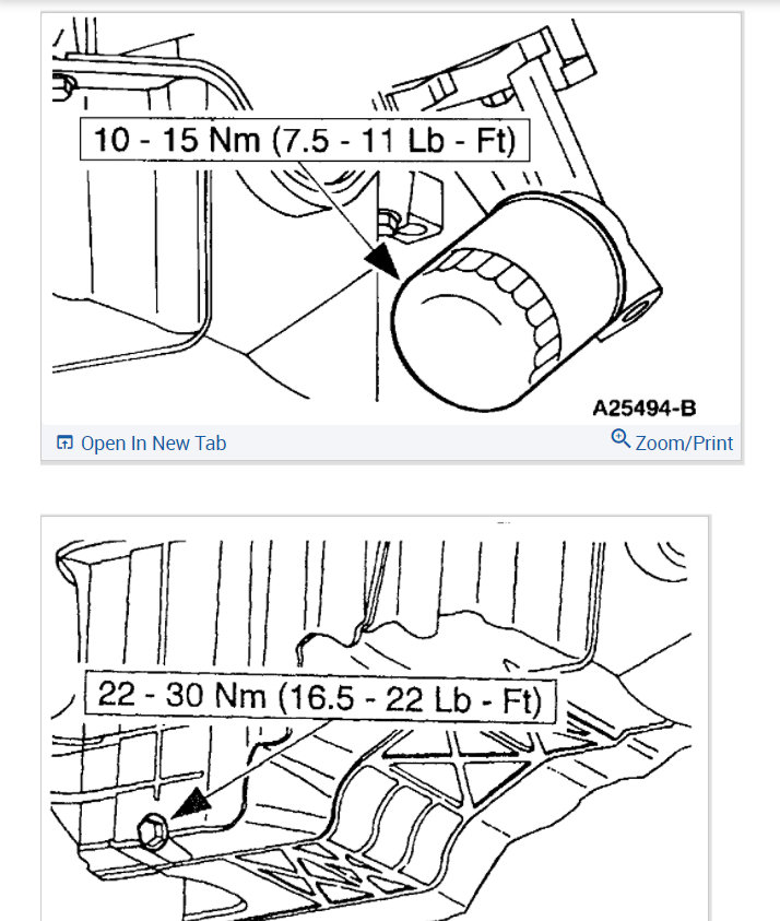

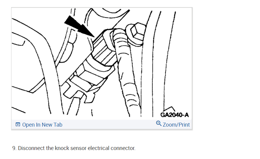

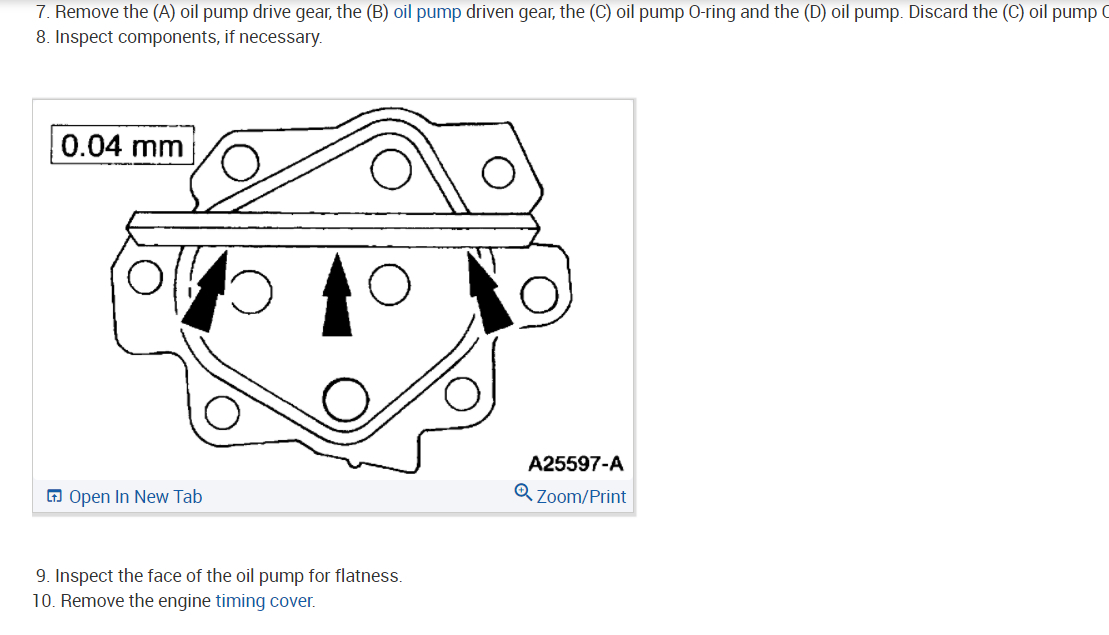

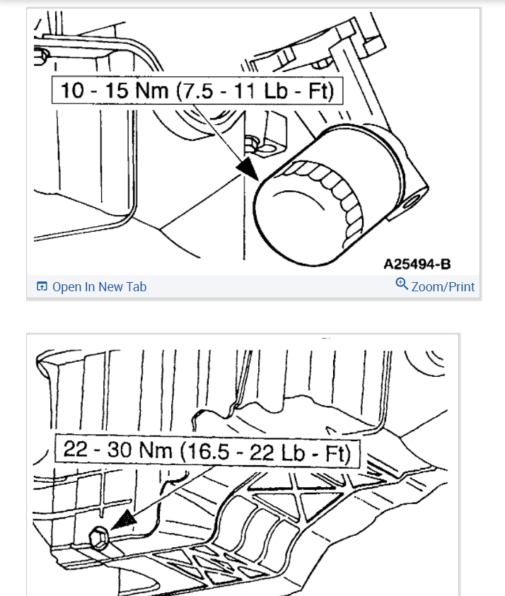

The pump is external in the housing that holds the oil filter. There are 2 gears there that make up the oil pump.
https://www.2carpros.com/articles/high-or-low-engine-oil-pressure

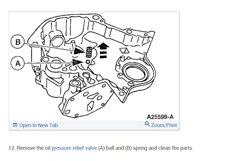

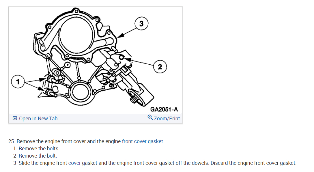

The oil pressure relief valve is in the front cover which will require removal of the front cover.

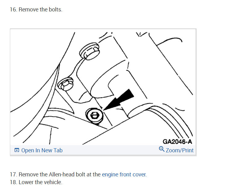

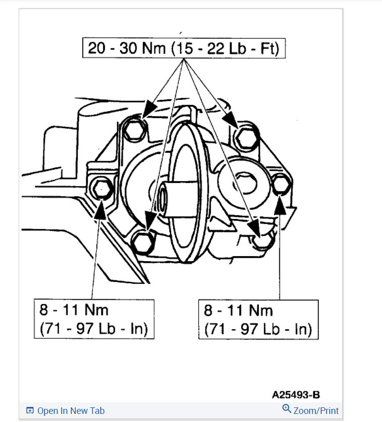

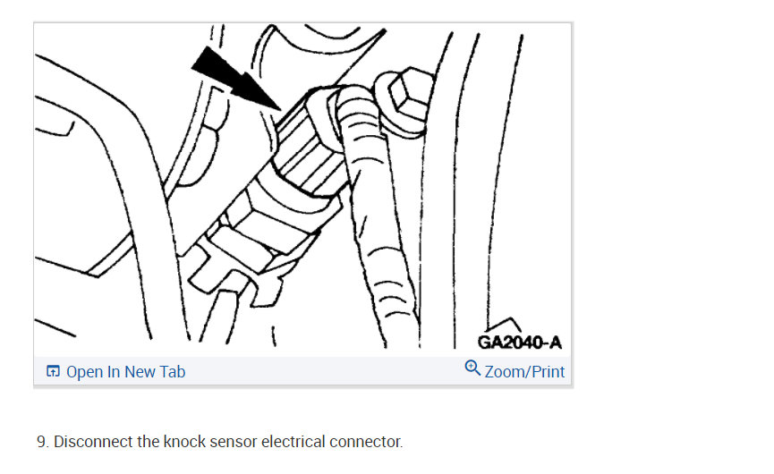

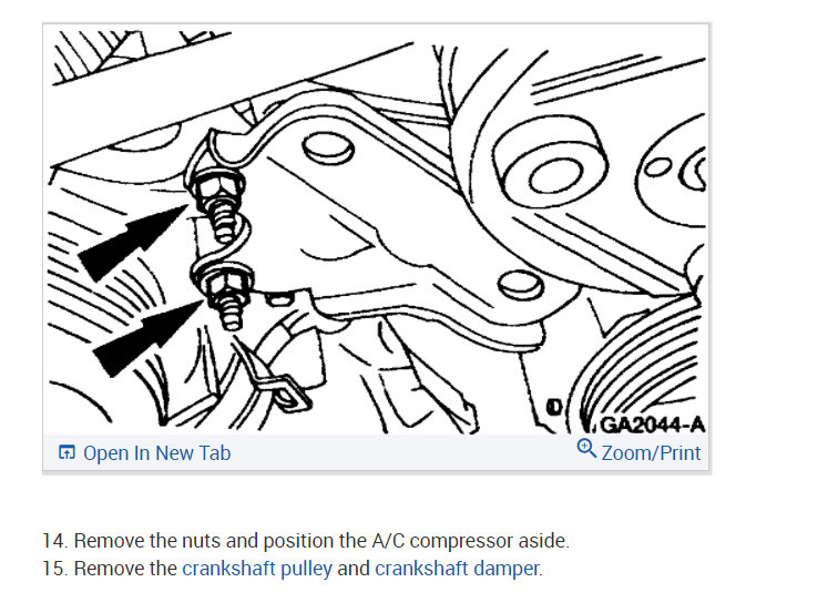

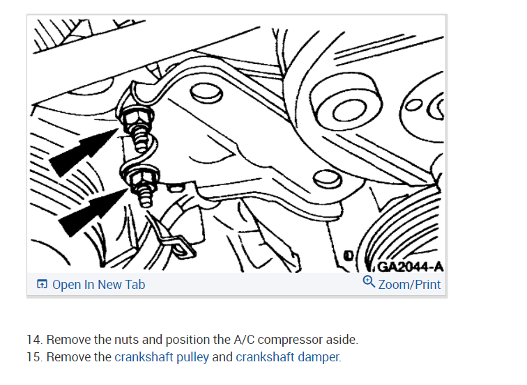

I attached the procedure below for you for the repair.
How hard? If you have never done one, it will be hard. It is involved. The book time at a shop is 4 to 5 hours plus parts.
