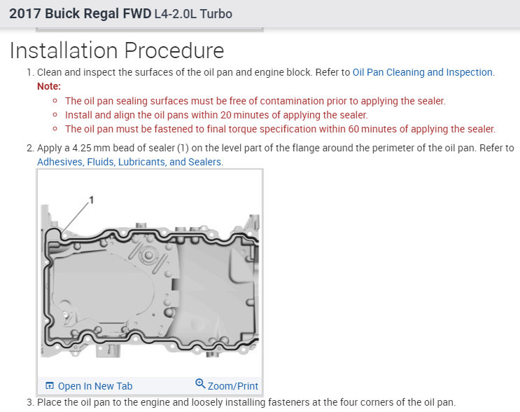

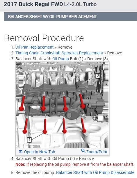

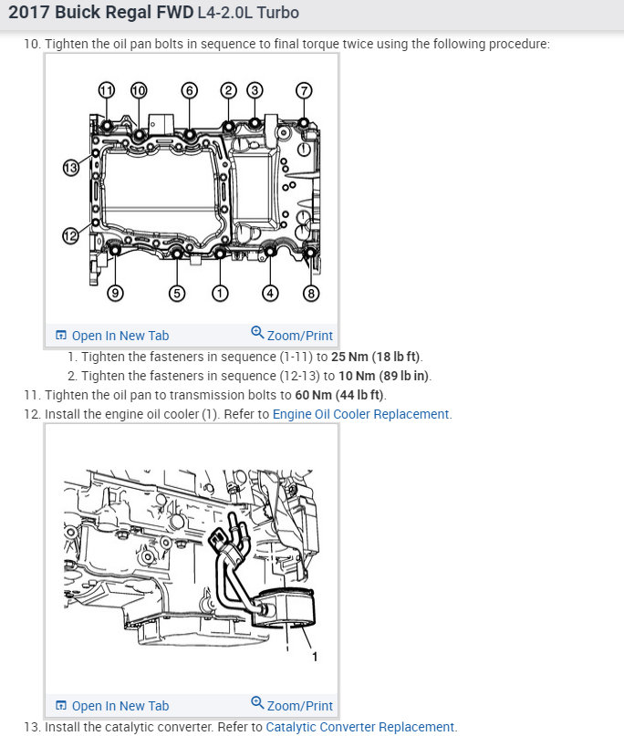

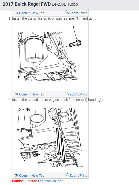

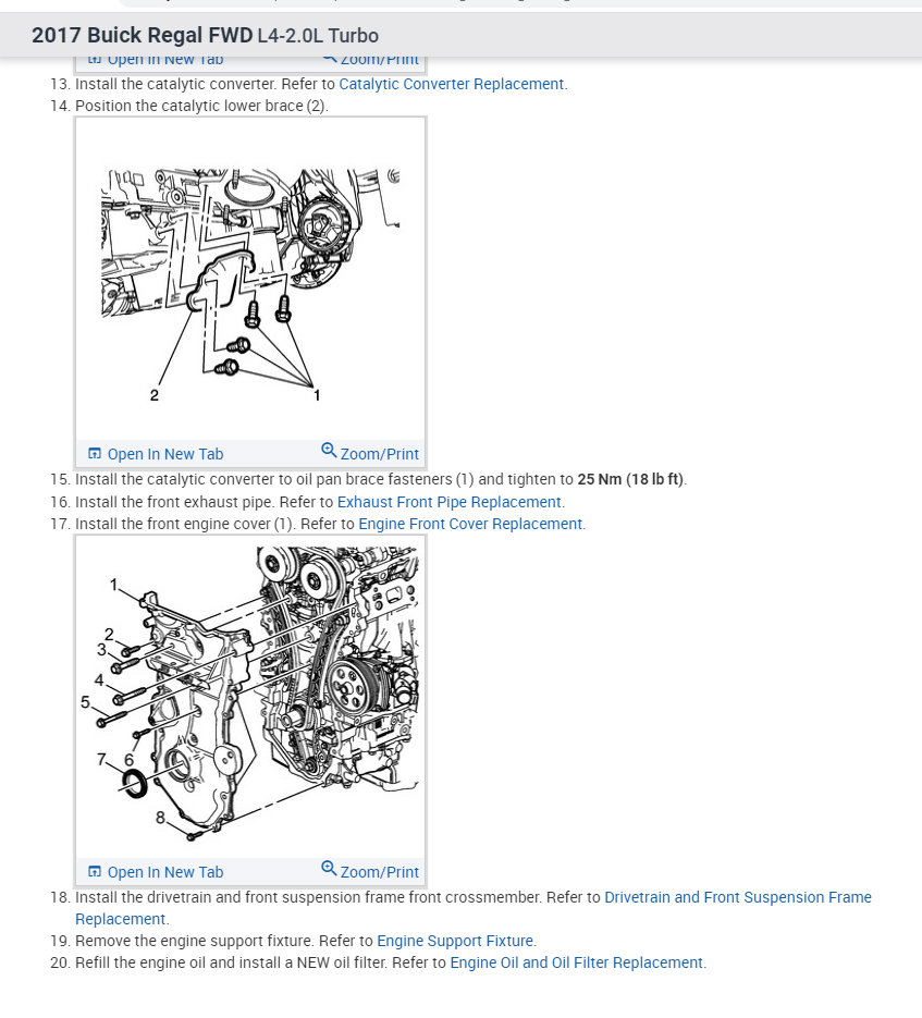

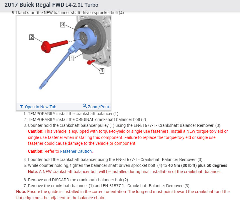

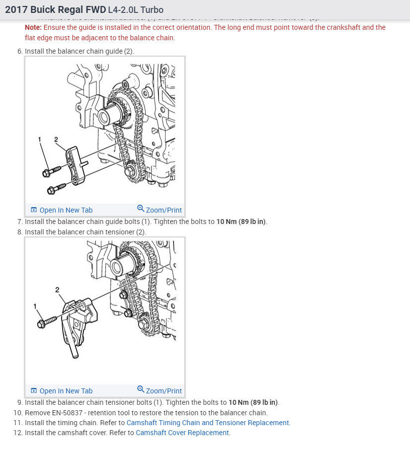

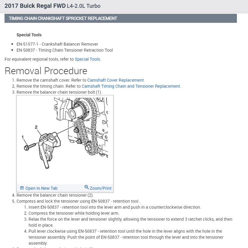

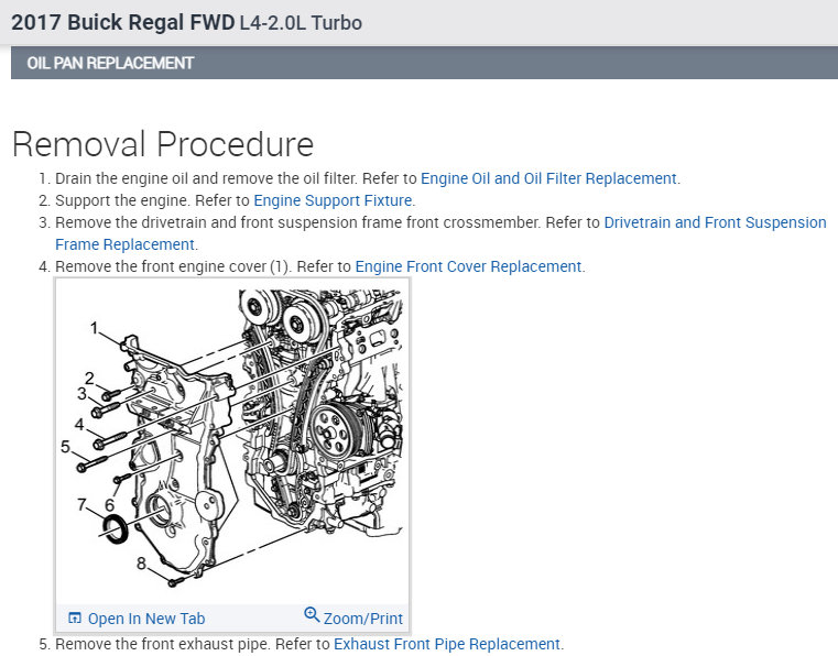

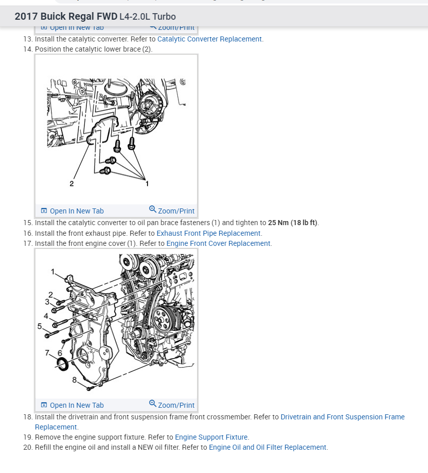

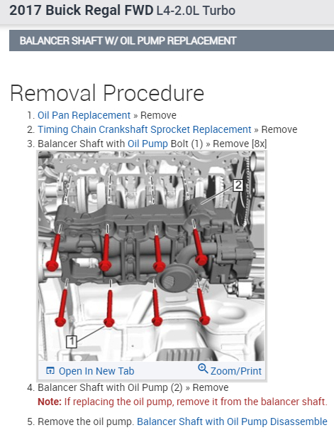

Need steps to remove oil pump.
Apr 8, 2022 at 5:24 PM
SQM
  • 6,383 POSTS

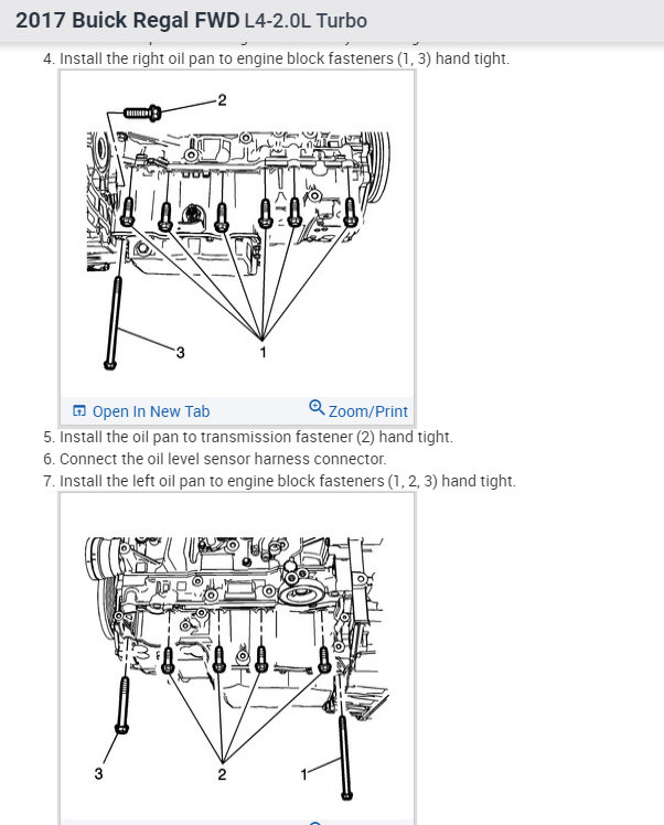

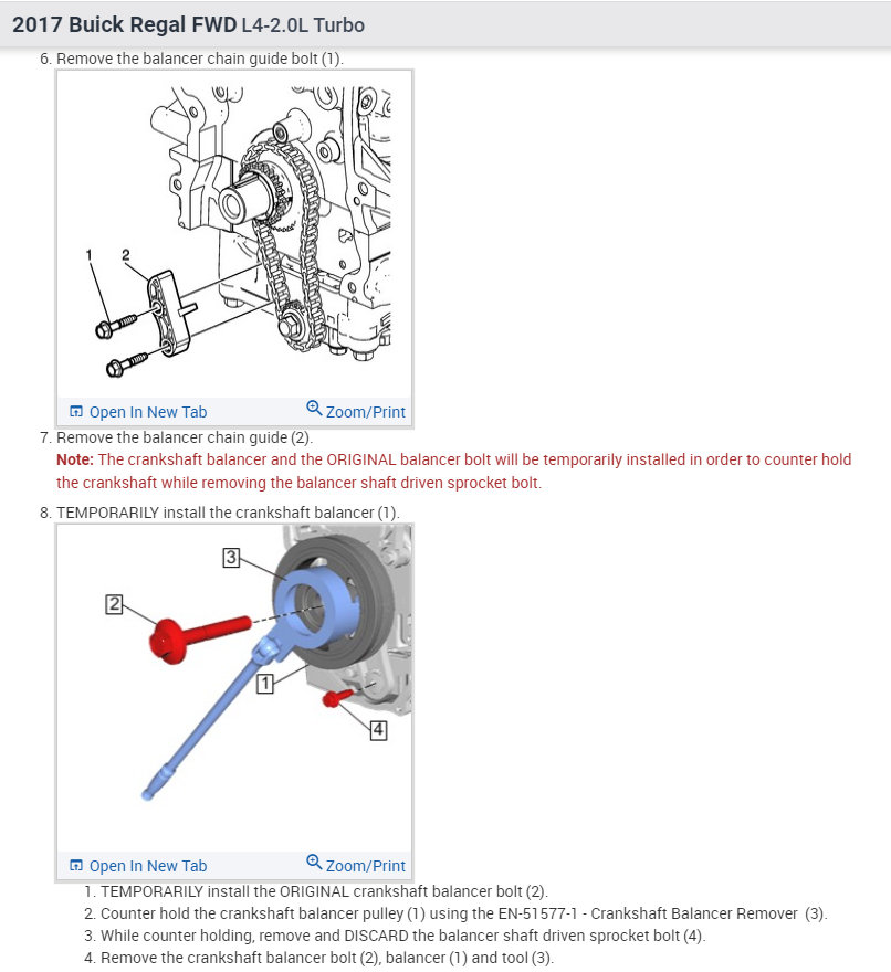

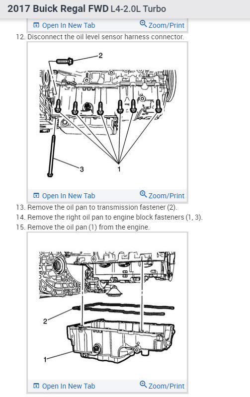

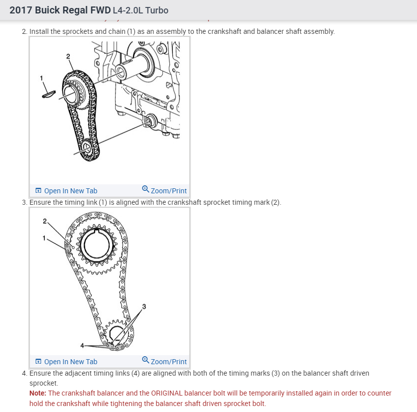

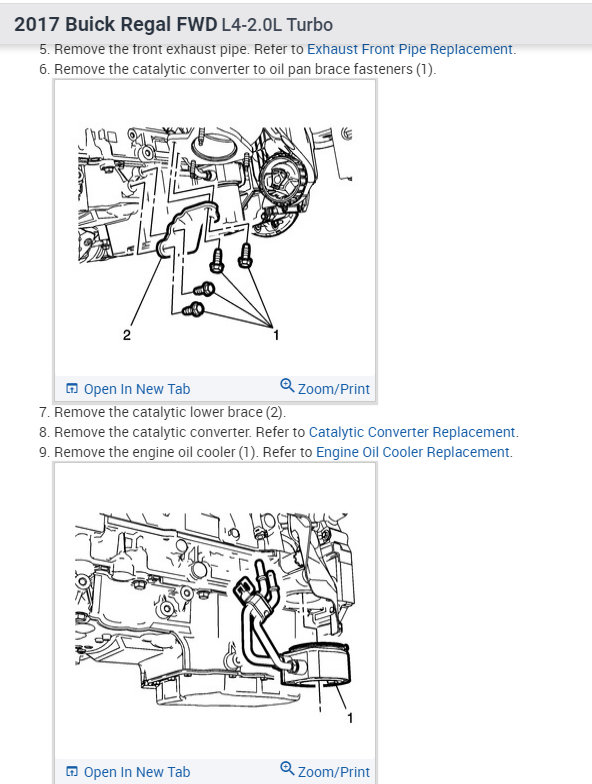

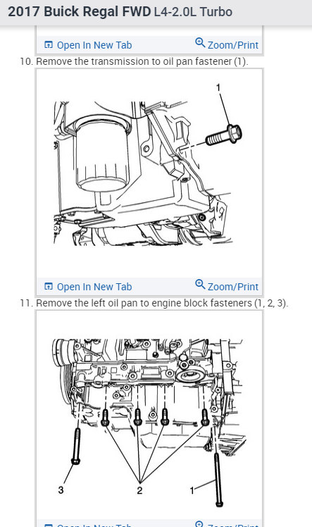

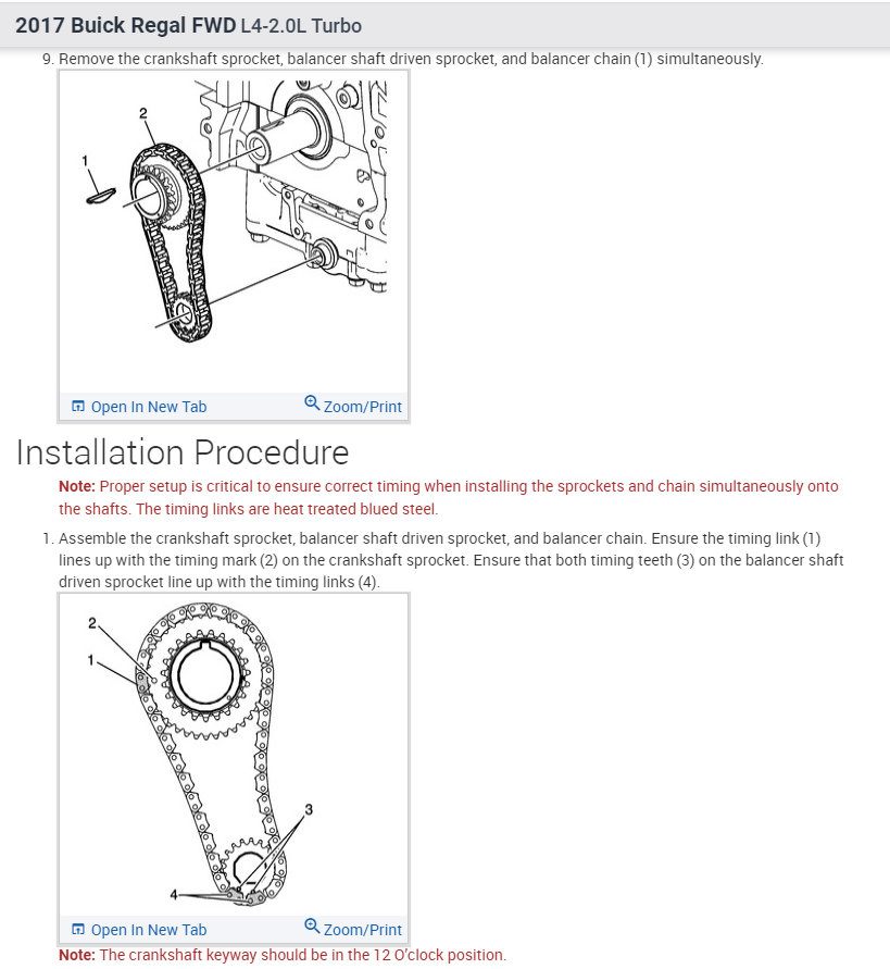

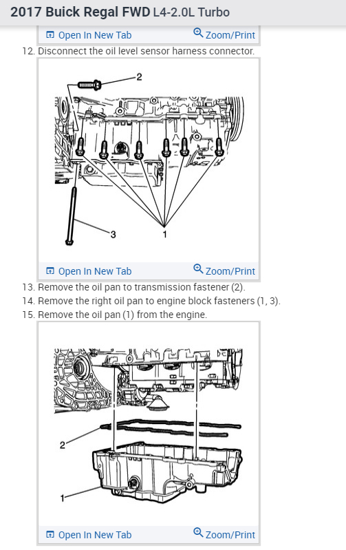

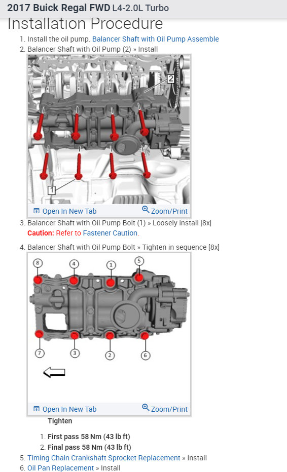

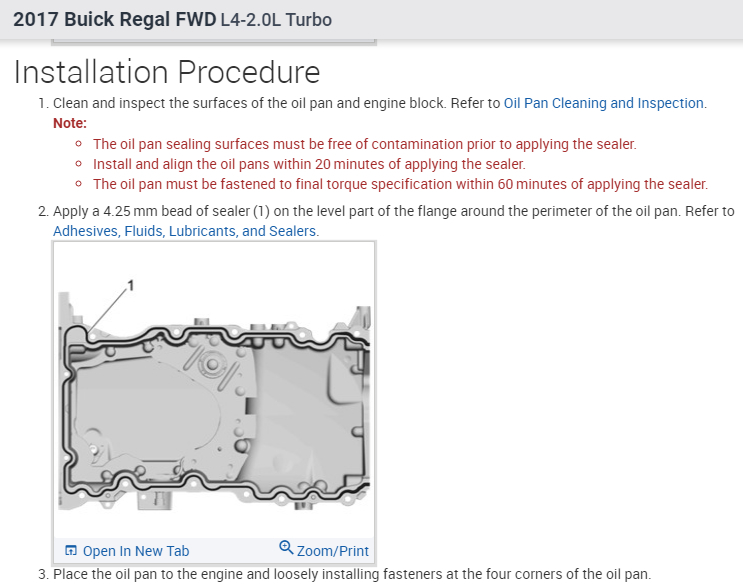

In order to replace the oil pump, first you will have to remove the oil pan as well as the timing chain sprocket.
I have attached all the procedures below, including all the torque specifications as well.
Apr 9, 2022 at 12:57 AM
