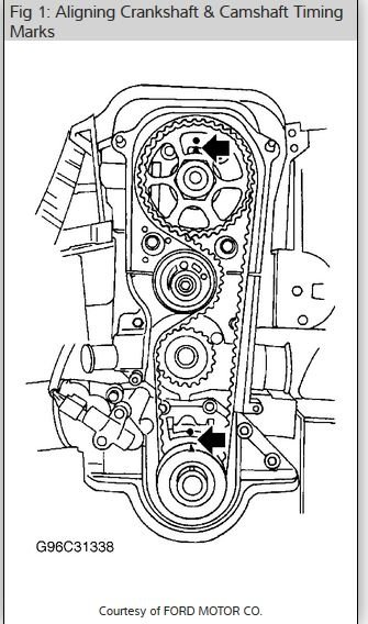

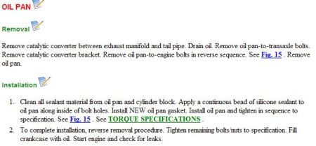

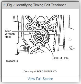

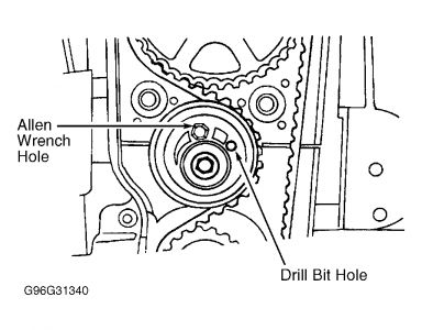

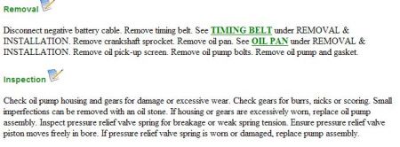

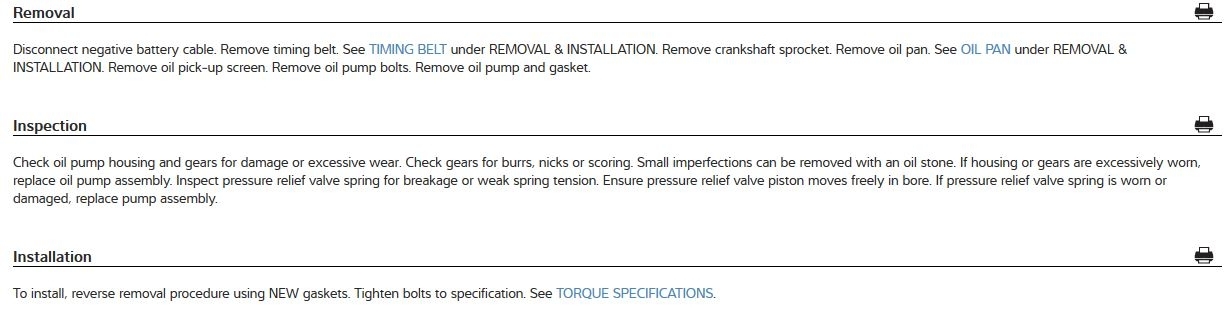

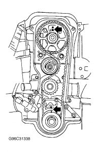

Need detailed instructions on how to remove and replace an oil pump in the car listed above (ZX2).
Mar 3, 2018 at 5:22 PM
HARRY P
  • 2,292 POSTS
I am attaching the complete guide from Mitchell1's Prodemand. This is a fairly involved job. Check out the diagrams (Below). Please let us know if you need anything else to get the problem fixed. Good luck.
Mar 4, 2018 at 4:49 AM
BADGER21
Engine Mechanical problem
2000 Ford Escort 4 cyl Manual
HOW DO YOU CHANGE AN OIL PUMP ON THE CAR
Oct 10, 2020 at 9:37 AM (Merged)
MHPAUTOS
  • 31,937 POSTS

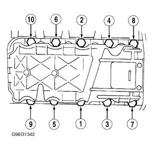

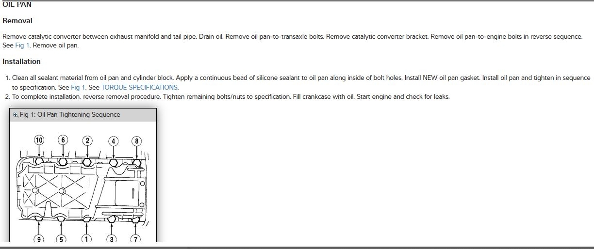

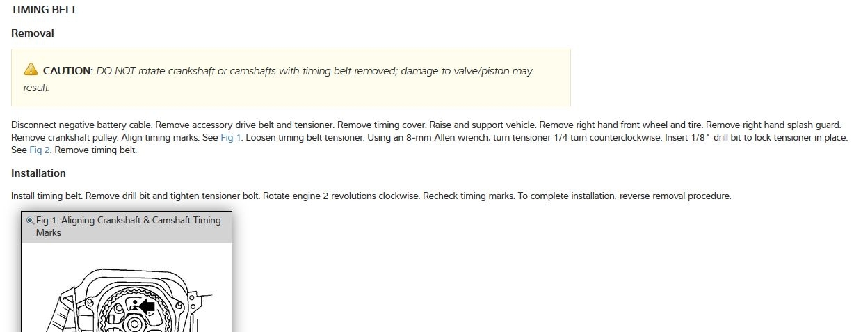

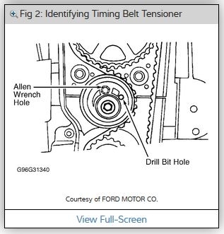

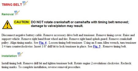

Hi there oil pump information see text and pics. Mark (mhpautos)
