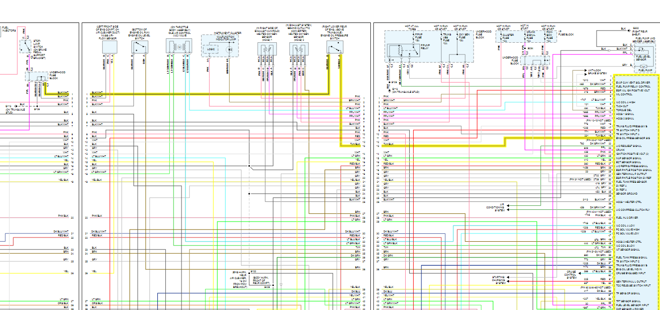

Can the Oil Pressure (PSI) be read through the OBD2 port using and app like Torque Pro on a 2002 Oldsmobile intrigue?
I have tried different PID's and I either get nothing at all or some random number like -16.9. The Application does light up green as active but I still do not get anything.
Can Oil PSI be gotten through the OBD2 port on this vehicle?
Many Thanks for Any Help!

Thanks for visiting 2carpros.com. On this model the oil pressure switch receives 12 volts and supplies the ECM with an on or off signal. So, unfortunately , it will not provide an exact pressure reading through obd2. I'll post the wiring info below so you can see it.

Thank you so much! This is quite helpful!
