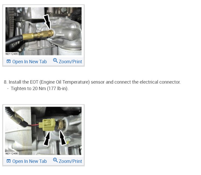

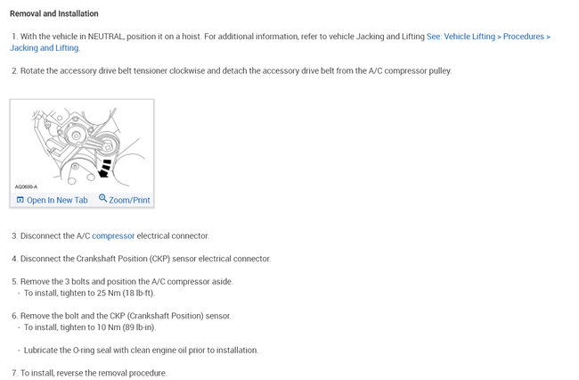

Problem 1. Any help on how to remove a broken abs cable and replacement?checked on YouTube on basic instructions but it looks different on a 750 super duty vs smaller trucks.

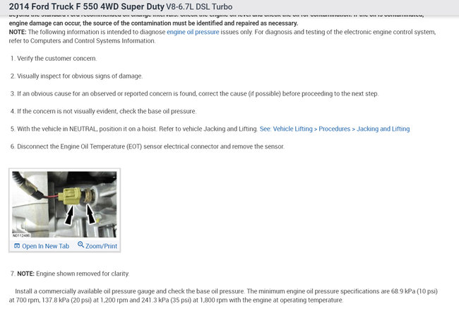

Problem 2. Oil gauge shows zero pressure and check engine lights on. Contrary to the indicators, engine runs fine. Need help to find where the oil sensor is at and replace it.

The only information I could find on this truck are in the diagrams below. Sorry we could be of more help. Check out the diagrams (below). Please let us know what you find.
