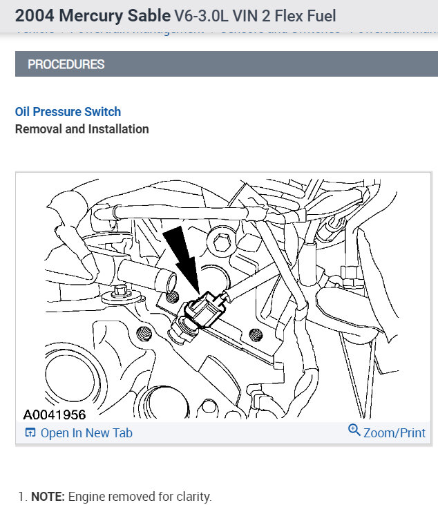

Where is the Oil pressure switch located?
2004 MERCURY SABLE
170,000 MILES • 3.0L • V6 • 2WD • AUTOMATIC
UNLOVELYCREATURE

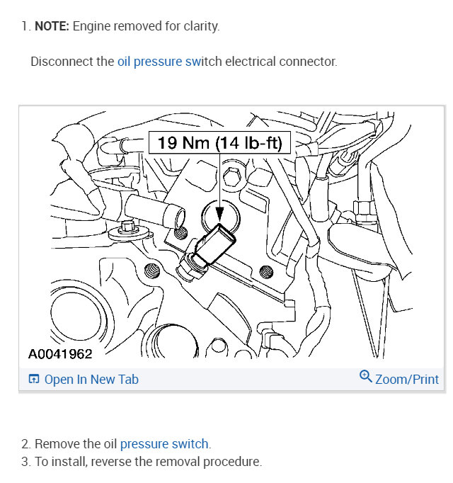

I cannot find the oil pressure sensor to change it out!
Sep 17, 2023 at 8:07 AM
  • 55,224 POSTS
The oil pressure sensor is located at the rear of the engine behind the cylinder head on the right side. Check out the images (below). Please let us know if you need anything else to get the problem fixed.
