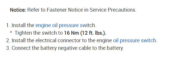

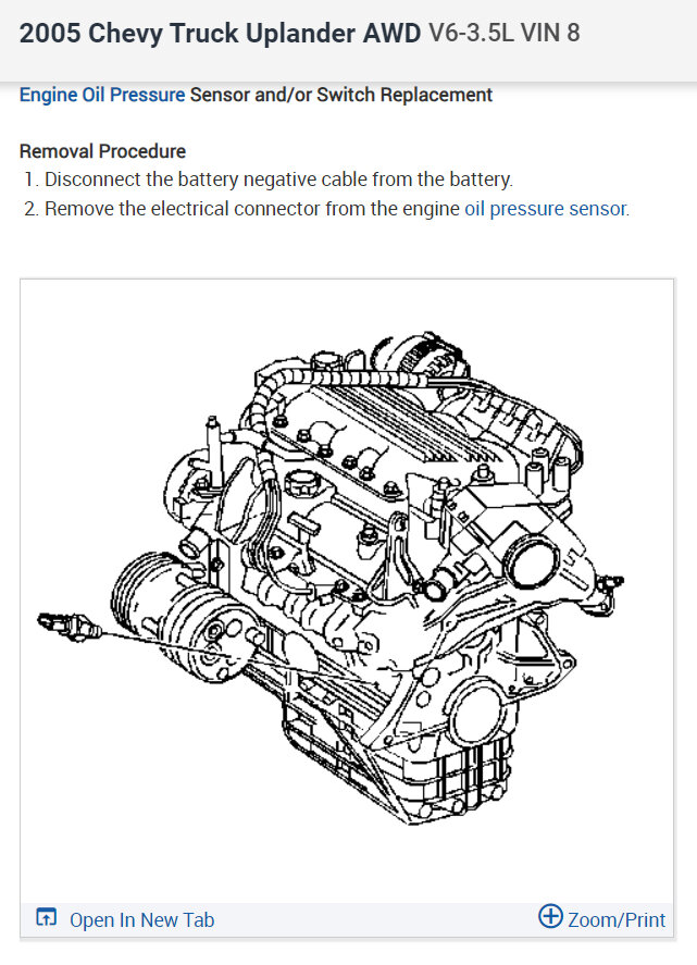

Oil pressure sensor or switch needs to be replaced trying to locate the oil pressure sensor or switch.

The oil pressure sensor is on the left side of the engine to the rear of the A/C compressor. Here is the location and how to change it out in the images below, you may need a special socket to remove it. Check out the images (below). Let us know if you need anything else.
