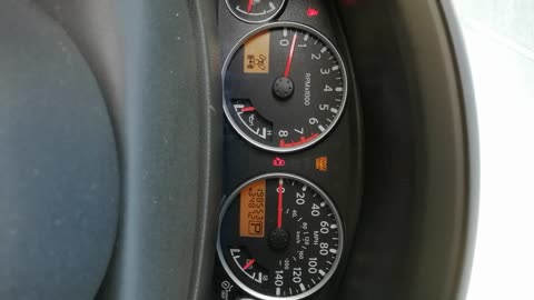

So we had just gotten our vehicle repaired about a month ago, and it seemed to fix part of the problem we were having. It would shake a good bit when pressing on the gas, and just generally seemed like it was about to break down. Some spark plugs were replaced which seemed to eliminate that problem, along with a gasket.
See the video below to see exactly what is happening. I was told that it could be the oil pump, but others said that it could just be a bad oil sensor. Any advice or suggestions would be amazing. Thank you!

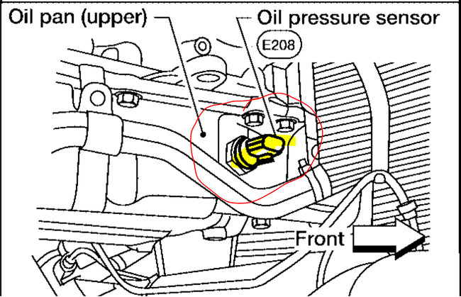

Does the light go off when the RPM's increase? If so, it could be either the sensor or (unlikely) the engine.
If you look on the oil pan (passenger side toward the front side of the pan) you will see the oil pressure sensor. Check to see if it is wet with oil. Also, remove the electrical connector and see if there is oil inside where it attached.
I attached a pic of the sensor. Check that and let me know what you find. Also, let me know if the engine is making any noise like knocking, ticking, and so on while the light is on.
Let me know

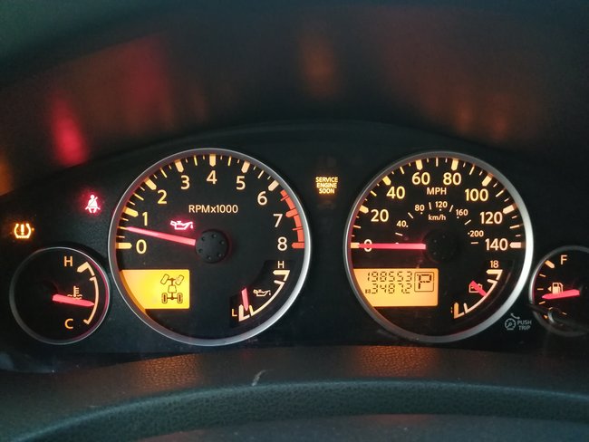

As far as the sounds, I'm not sure there is anything too alarming, but I also know nothing about cars. I will try to send a quick video with the sound of the engine while the light is on.
And yes, the light does go off when the RPM's increase. The oil light can sometimes take several minutes after the oil gauge drops. I would say that during those minutes, the pressure just keeps getting just slightly lower, and then the oil light will pop on.

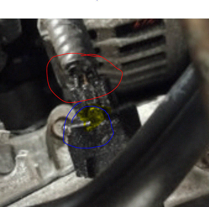

Also, I was able to locate the sensor. So far, I am hesitant to detach the electrical part, but if you don't think it is to worry about, I will go ahead and do that. See the photo attached. Took me a while to find that little thing!
Oct 21, 2020 at 2:46 AM
  • 110,241 POSTS
It won't hurt to disconnect it. I copied a portion of your pic and circled two things. In red, I don't like the look of the wires. Can you confirm they are not damaged? Also, the release for the connector is circled in blue. Press that as you remove the connector.
As far as a video, you can upload it here. It's done all the time.

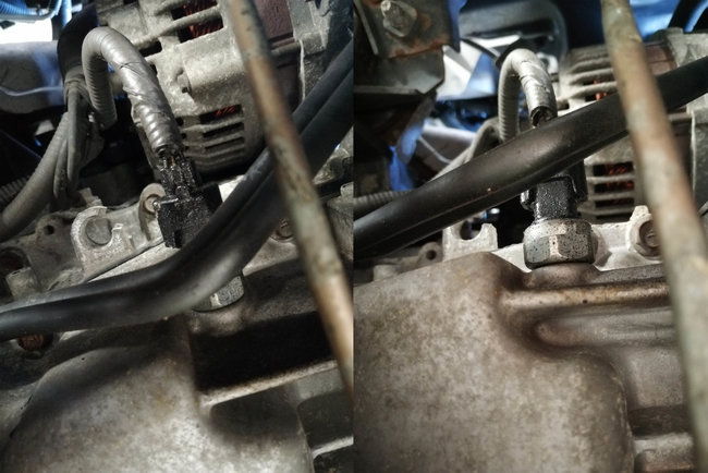

Okay cool. I'll definitely do that. Going to try to so that earl next week or hopefully this weekend.
Thank you for sending my photo back with the circles to make thing extremely clear. It does look a little weird. Definitely dirty and I don't know if the wires are supposed to be showing quite like that period that might be normal though not sure.

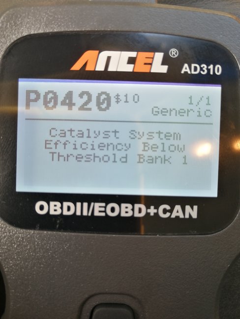

oh and I got one of those scanners on Amazon. Super cheap one. I took a photo of what it said below.
I don't know, but I'm assuming this is related to the oil pressure problem. A symptom?
Oct 22, 2020 at 7:25 AM
  • 110,241 POSTS
The code, P0420, is related to the catalytic converter. That code usually indicates the converter needs replaced. The only connection I could even suspect would be if the converter was plugged enough that it is causing an extremely low idle speed. Have you noticed the idle speed to be very low?

Here's one of the videos I had taken the other day which shows the idle speed in part of it. When I connected the code reader, it said that the rpm's went down to almost 450.
Oct 23, 2020 at 1:51 AM
  • 110,241 POSTS
I have a feeling it is the sensor. RPM's are very low which causes the pressure to be lower.
